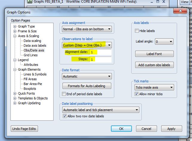

Hi everyone,
I'm drawing a kind of impulse response graph. There is an option to define the interval of the horizon (see the attached picture). Is there any way to make a code for that too?
Thank you a lots!
observations to label
Re: How to customize the obs axis in graph?
Postby EViews Jason » Thu Jan 22, 2015 10:26 am
See the documentation for the datelabel proc in graphs. More specifically use the 'interval' option.
For the equivalant settings in your pic use:
graph1.datelabel interval(obs, 1,1)

It works well now, thank you very much!
