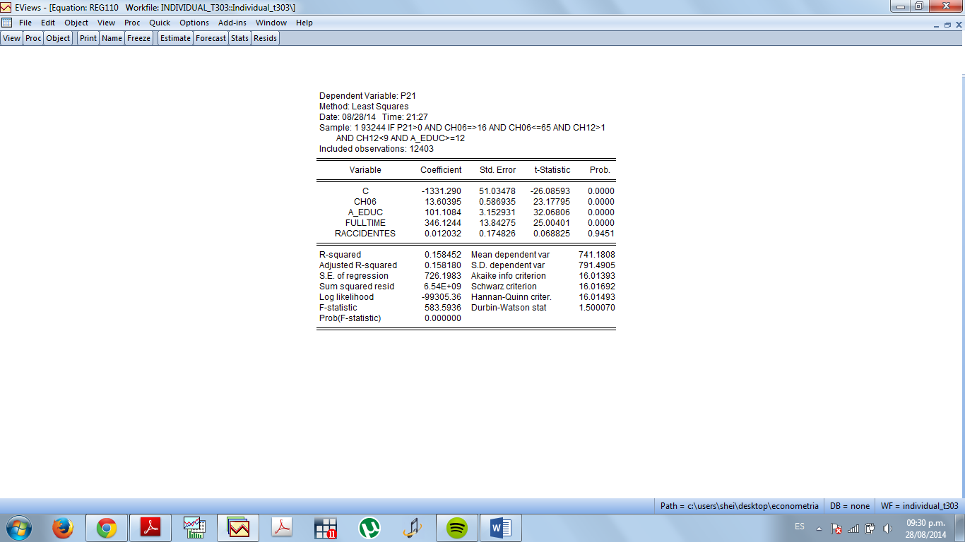

Ok, the equation looks like this.
Re: MULTICOLINEARITY
Posted: Thu Aug 28, 2014 8:35 pm
by startz
Something doesn't make any sense. When EViews says "near singular matrix," it won't estimate the equation.
