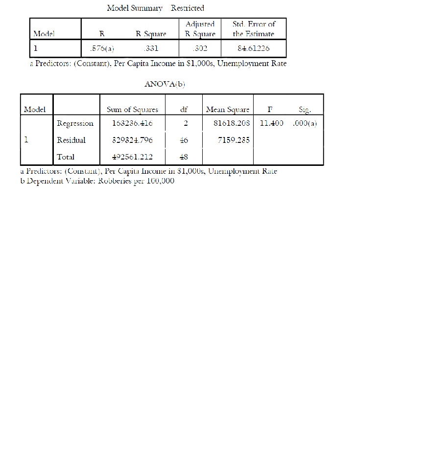

i attach an image!
in anova table there is three row: Regression, Residual and Total, i want the number that is in front of regression (in this example 274405.373)

Unfortunately that picture doesn't describe what that number is. What is the calculation you want?

SST = SSR + SSE
SST= ∑〖( y - y ̅ )〗^2
SSR= ∑〖( y ̂ - y ̅ )〗^2
SSE= ∑▒〖( y - y ̂ )〗^2
Re: SSE,SSR,MSE,MSR
Under those definitions, SSE is shown on equation output (as sum of squared residuals). SST is shown by opening up the dependent variable series and clicking on View->Descriptive Statistics->Stats table.
SSR you'll have to calculate.
