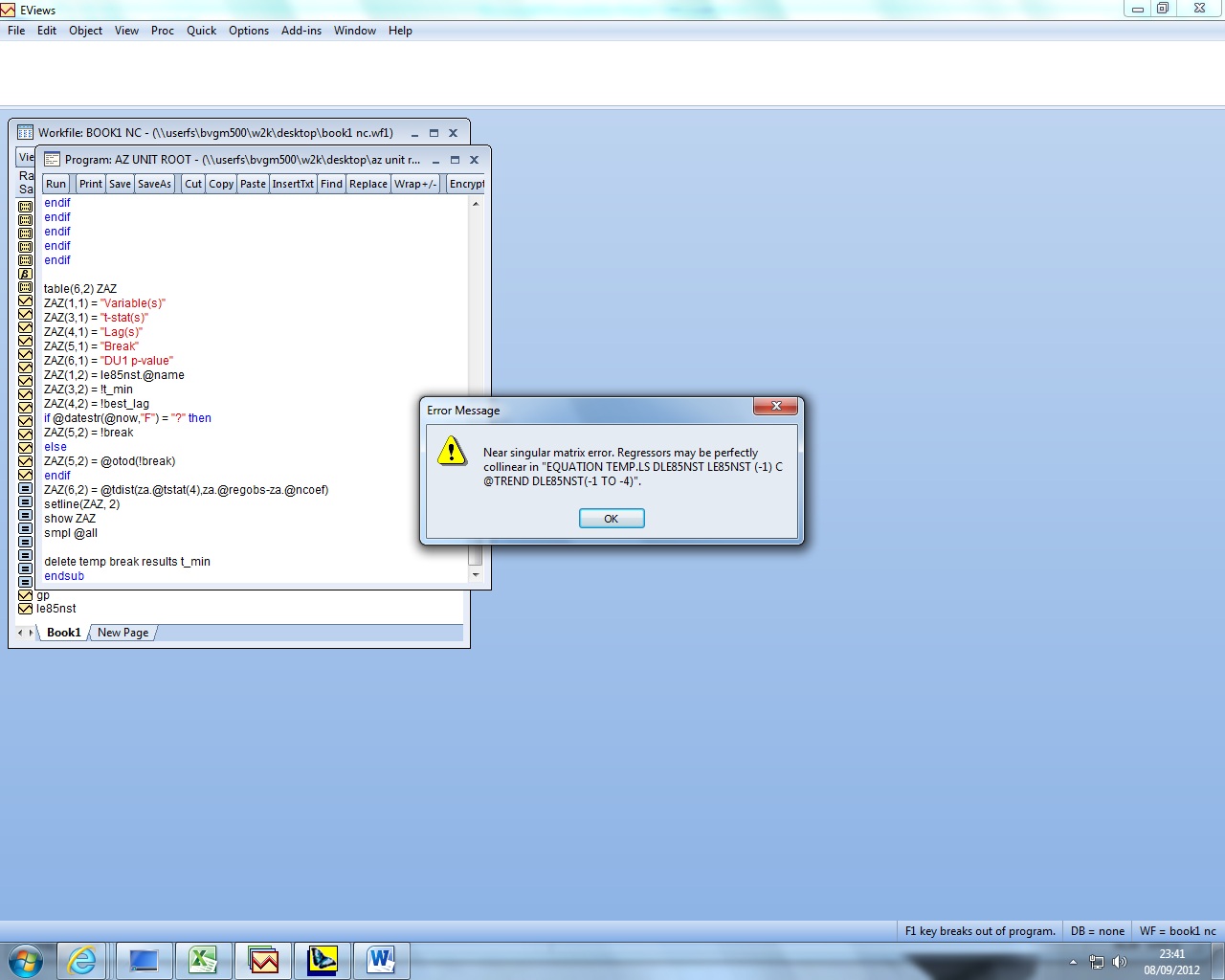

Re: ZAURoot (Zivot-Andrews Unit Root test)
Use the code here: http://forums.eviews.com/viewtopic.php? ... 1432#p4925The series I get the error is the one named le85nst. The error I get from this serie is Near singular matrix error: Regressors maybe perfectly collinear.
Hello Trubador,
I get the error attached
do you know why I might get it?
- error.jpg (196.54 KiB) Viewed 39267 times
Just change the initial part of the code:
And then you should be getting the following output:

call zivot(le85nst,"C",12)Variable(s) LE85NST
t-stat(s) -3.618547
Lag(s) 1.000000
Break 2000M01
DU1 p-value 0.022781
