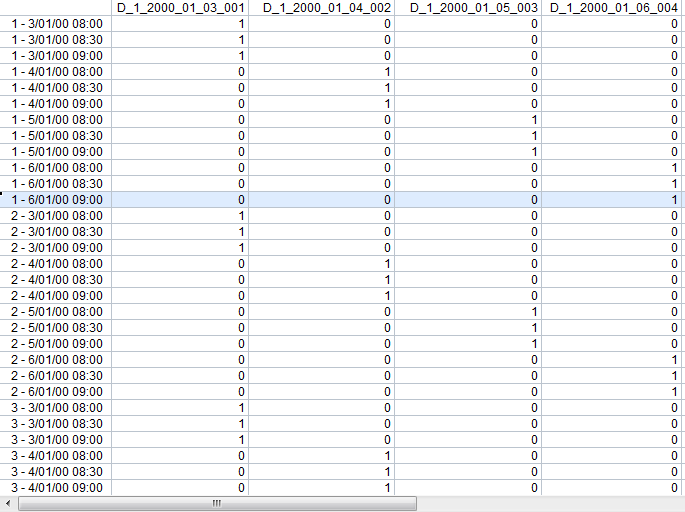

could i generate this series dummy, i mean to generate just 4 dummy series ok, but it generate 8 series dummy contained zero value
wfcreate 30min(Mon-Fri,8:00-9:00) 03/01/2000 06/01/2000 3
!size = 3 ' Every four observations go into one dummy.
for !i = 1 to @obsrange
!id = @floor((!i - 1) / !size) + 1
%series_name = "d_" + @str(!id, "i03")
if not @isobject(%series_name) then
series {%series_name} = @floor(@trend / !size) + 1 = !id
endif
next- Attachments
- interday_spanning.png (26.88 KiB) Viewed 15408 times
EViews Matt
- Posts: 591
Re: rename dummy and diagonal dummy
Sure, since you have three cross sections just change the upper limit of the for loop from @obsrange to @obsrange / 3.
