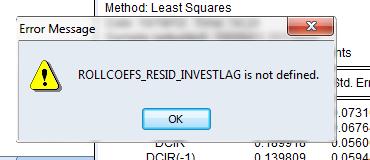

Posted: Fri Oct 18, 2013 11:39 pm
by Nazirul_Monash
I ran Rolling Reg add-in in EViews 8 and rand into this error:
roll not defined.jpg (12.63 KiB) Viewed 470955 times
I thought maybe it couldn't handle parentheses or other signs but when I took those non-letter symbols away, it only fix it with for variables. So, I'm not sure what the problem is now.
Help would be greatly appreciated. Thank you.
Have a nice day.
