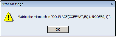

When I try to change the equation with more variables, I think the error means I need to change the number after the coefs in the sentence below, but I am not sure how many I shud put there to replace the "!"? or should not to replace it but add sth else?
Please see screen shot!
' estimate equation - where the equation is P =c(1) + c(2)naturalgas +c(3)coal+c(4)wool+c(5)qcmid eq1.ls usdaud c naturalgas coal wool qcmid ' store coefficients colplace(coefmat,eq1.@coefs,!j)

This is because the storage matrix was set to be 2-by-!nrolls. Now the number of coefficients is 5 so that we need to change the storage matrix size.

' estimate equation - where the equation is P =c(1) + c(2)naturalgas +c(3)coal+c(4)wool+c(5)qcmid eq1.ls usdaud c naturalgas coal wool qcmid ' store coefficients colplace(coefmat,eq1.@coefs,5x5j)
Hi Esther,
Please see if I can change the "!" to "5x5"? or please could you let me know how should I amend this?
Many thanks!

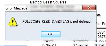

I ran Rolling Reg add-in in EViews 8 and rand into this error:
roll not defined.jpg (12.63 KiB) Viewed 469798 times
I thought maybe it couldn't handle parentheses or other signs but when I took those non-letter symbols away, it only fix it with for variables. So, I'm not sure what the problem is now.
Help would be greatly appreciated. Thank you.
