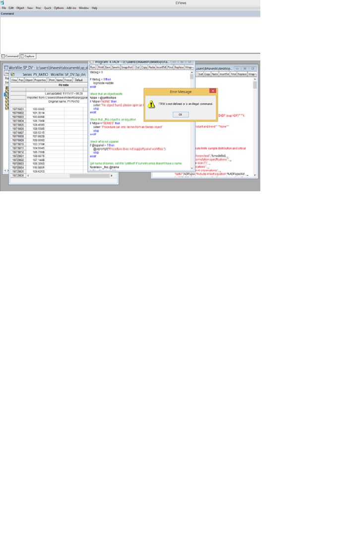

When I run the program having the simulation I have found that the EViews giving message !TRW not defined and is illegal command.Hrnce, I cannot complete the procedure. I am attaching the output for reference.
Looking forward for your reply,
Regards,
Prashant

I do get the same error as jchomicki, where a warning Message pops up that TStat_max is not defined.
Has there been any fix yet I didn't see?

Dear rtadf users,
Xiaohui (Sharon) Wu, an rtadf user, has finally found the source for the annoying "tstat_max" bug.
I see several posts on the Eviews forum mentioned the "TStat_max_max is not defined" error, which I encountered myself too. After looking at the codes, I find the Matlab function says "function [ tstat_max, radf_cv ] = SIM_RADF( obs, win, rep, d, eta ,beta )", while in the RTADFSIM_MATLAB file, it says "xrun "[tstat_max sadf_cv]=SIM_SADF(T,t1,rep,delta,eta,beta,adfspec);"". So, there is one more input in the .prg file than in the .m file, namely the "adfspec". When I delete "adfspec" in the .prg file, everything works fine.
The latest version of the addin (https://www.jstatsoft.org/article/view/v081c01) solves this issue by adding the "flag" term to the Matlab SIM_*ADF function. However, the version that appeared in the EViews addin repository was outdated and contained that annoying bug. Thanks to Sharon and Gareth, the latest version of the addin has been uploaded to the EViews repository and should work just fine.

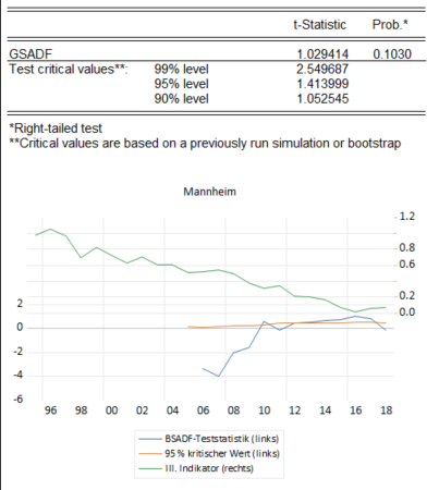

I am having a question regarding the results of the following GSADF-Test.
As you can see in the attached immage the timeseries I want to test is declining (therefore I asume as a non expert in this field that my autoregressive parameter is probably smaler then 1). Does anybody know why the test is confirming me the alternative hypotheses that the autoregressive paramter is taller then 1and implies an mildly explosive root from the year 2012 on?
I set the parameters n=d=1
Any help is very much appreciated.
KR Pascal
