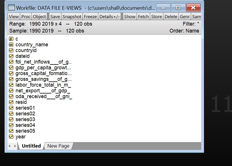

I have encountered another problem. Why it is showing series file name .Is there anything wrong. It should not be here as far as I know
screenshoot panel data.jpg (94.35 KiB) Viewed 57064 times
Re: How to enter data into a panel workfile.
Postby startz » Wed Mar 03, 2021 12:24 pm
What version of EViews are you using and has it been updated? When I load in your file I do not got the "series."

I am using E-views 11 student lite version
Postby startz » Wed Mar 03, 2021 2:39 pm
I do not see why it's not working then. Guess it'll have to wait for one of the EViews people.

I need to solve this problem by tonight. Tomorrow I have to submit some tests and discuss. I don't understand why in my eviews 'series' is showing up. Where I went wrong, I do not have any idea.Please help me out
Posts: 13612
Postby EViews Gareth » Wed Mar 03, 2021 3:02 pm
Just ignore them?

Postby shaliza » Wed Mar 03, 2021 3:12 pm
Will it not gonna affect the test or any estimation if I ignore them?
Posts: 13612
Postby EViews Gareth » Wed Mar 03, 2021 3:18 pm
No
