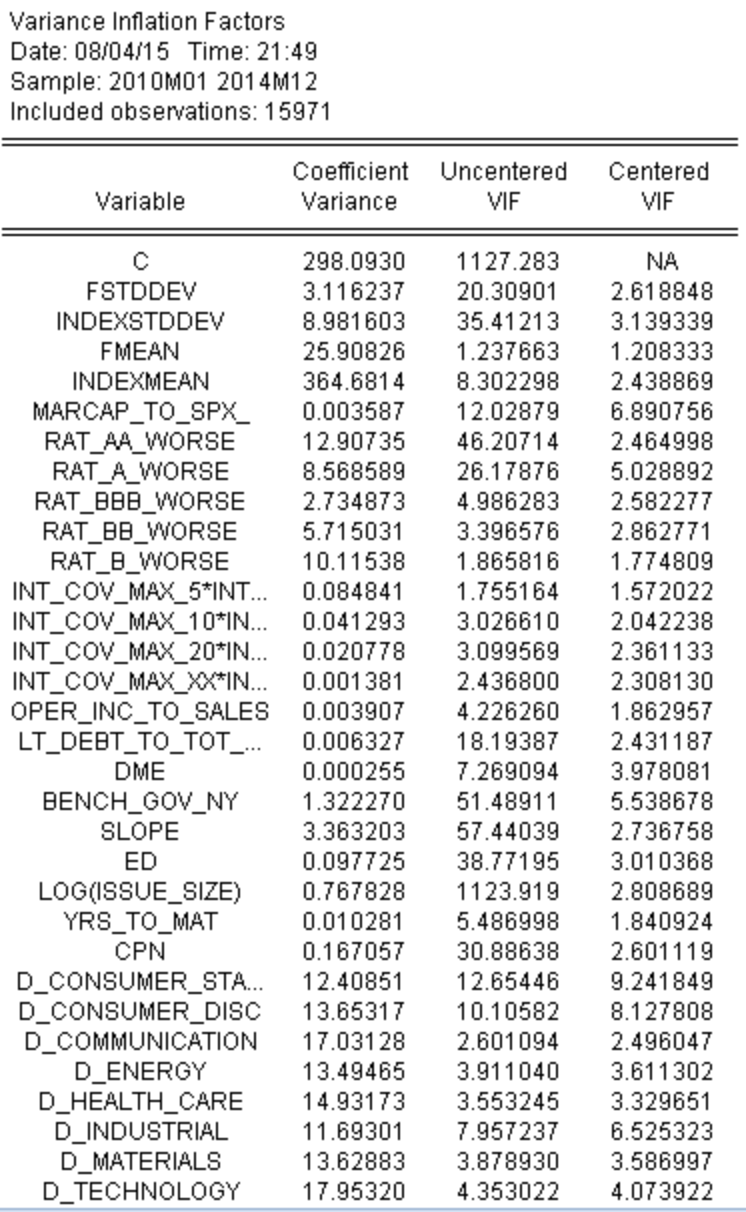

You can actually test for multicollinearity based on VIF on panel data. lets say the name of your equation is eq01, so type "eq01.varinf" and then click enter. then you will get centered (with constant) vif and uncentered (without constant) vif. Keep in mind, if your equation dont have constant, then you will only get the uncentered.
When having a constant in a regression does it then only make sense to look at the centered? It seems like there is a huge difference. I have correlation up to 70%. Does it make most sense to ommit some variables or just be in mind of possible multicolinarity?
Skærmbillede 2015-08-04 21.50.05.png (119.65 KiB) Viewed 16299 times
