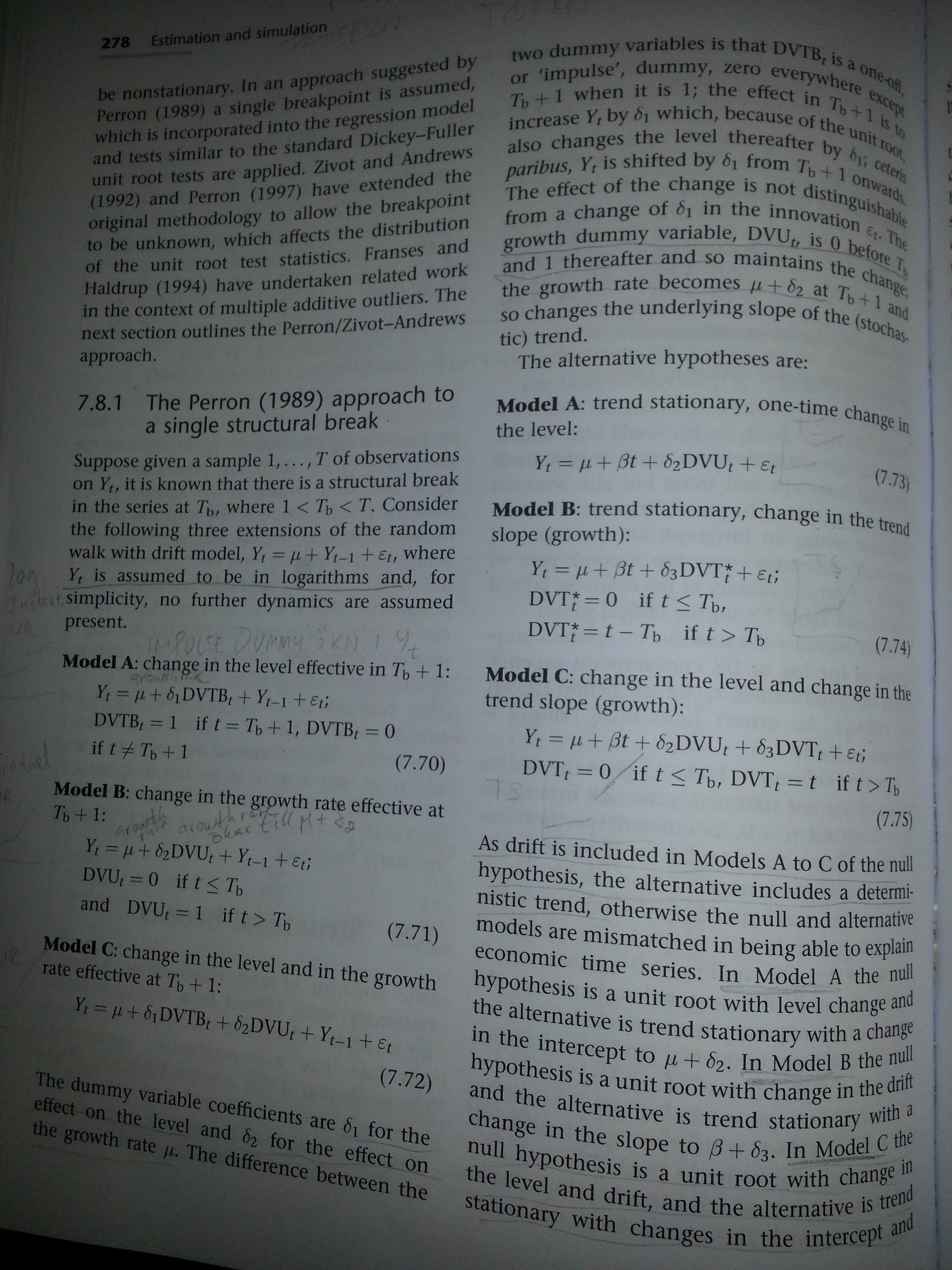

(See the attachment over the formulas and notations used. It is a photo over this Perron's 1997 method (from Pattersson, 2000). It should not infringe any copyright rules since I am posting my own photo of only a part of a page).
Notations and formulas used
Notations and formulas.jpg (1.56 MiB) Viewed 12827 times
In summary, if I change the magnitude of the impulse dummy from e.g. 1 to 0.5 this should change the critical value (the critical value that should give a statistical size of exactly 5%). Therefore, the empirical statistical size would be different from 5% when the value of the impulse dummy in DVTB_ser is changed.
I can see how critical values can be simulated when we do NOT have a structural break under H0 (or a possibly a structural break of known size), but not when having a structural break under H0.
- Or with what data generating process (DGP), and with which parameters, is the critical value simulated??? Please alter the code above so that I can see exactly how the DGP really looks like under the H0.

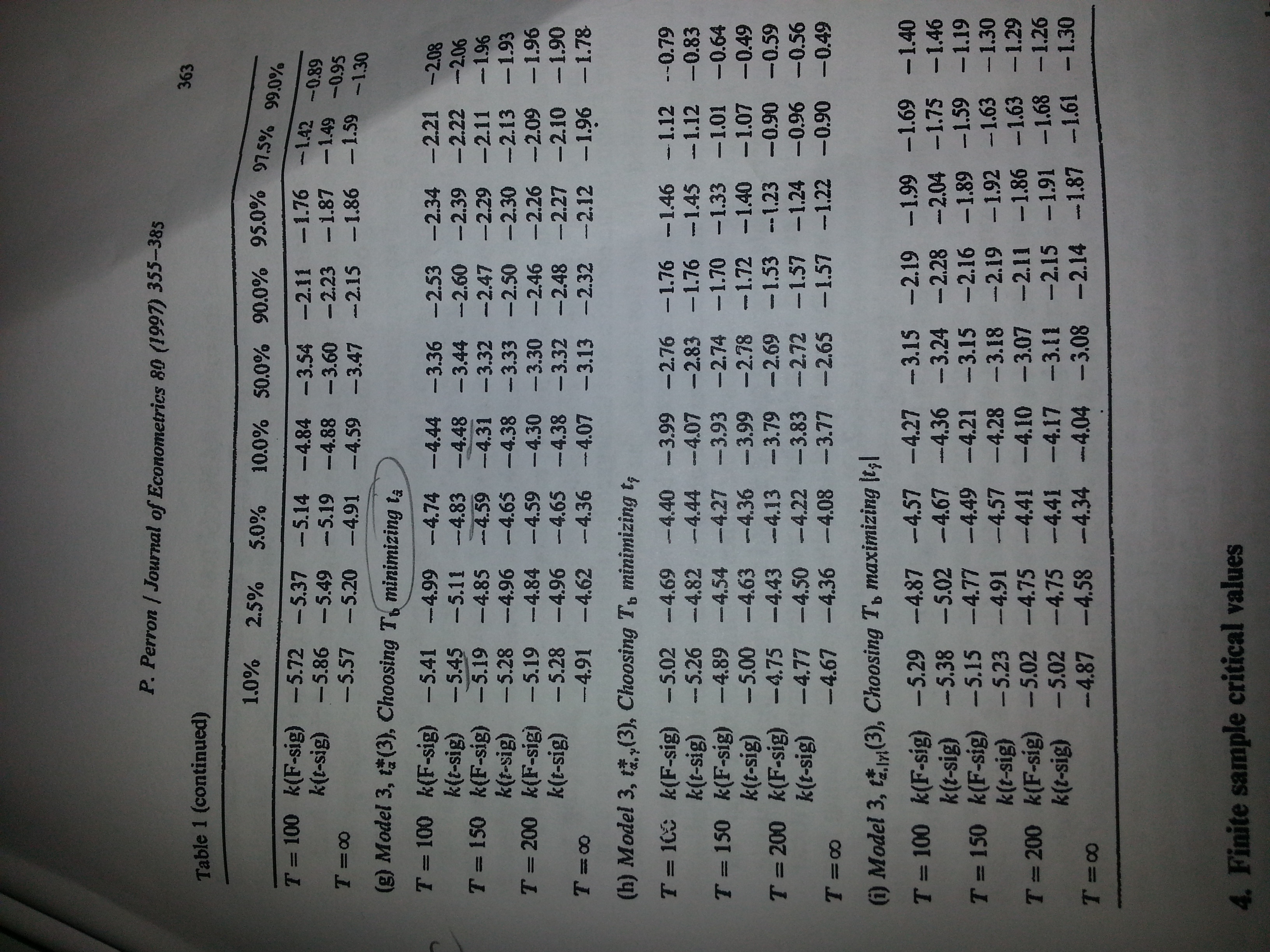

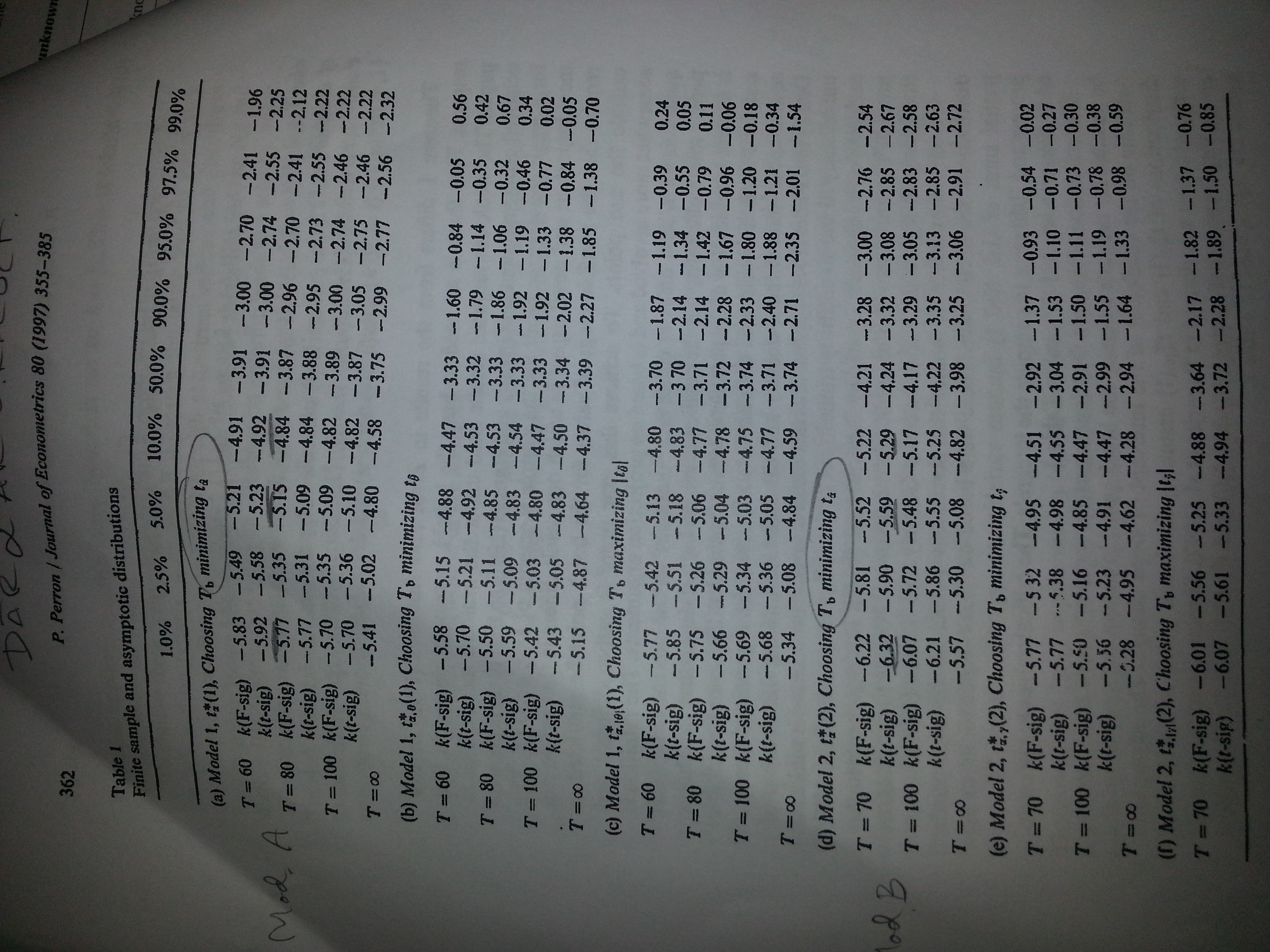

2. Another thing, when checking the critical values at page 362-363 in Perron (1997) is it the “k(t-sig)” row that table one should use for getting the critical values? I get this impression by reading your pdf-documentation. Is “(a) Model 1” min t(alpha-hat) in Perron (1997) related to your Model A in y.ppuroot(lag=4, model=A)? Is “(d) Model 2” min t(alpha-hat) in Perron (1997) related to your Model B in y.ppuroot(lag=4, model=B)? Is “(g) Model 3” min t(alpha-hat) in Perron (1997) related to your Model C in y.ppuroot(lag=4, model=C)?
Here are the critical values from Perron (1997):
Table1(2)
Table2(2)
3. Also it seems like your y.ppuroot(lag=4, model=B) corresponds to Patterson's (2000) Model C, and when using your y.ppuroot(lag=4, model=C) this corresponds to Patterson's (2000) Model B. Patterson (2000) is based on Perron (1997). Am I right? See the first attachment in this post with Patterson's formulas.
