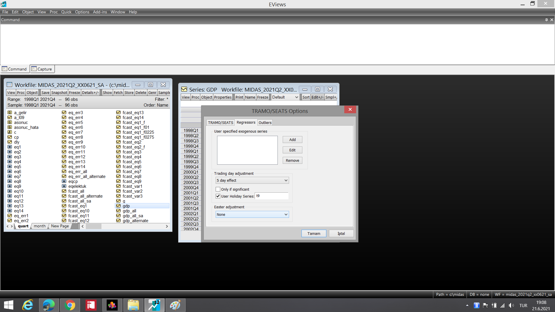

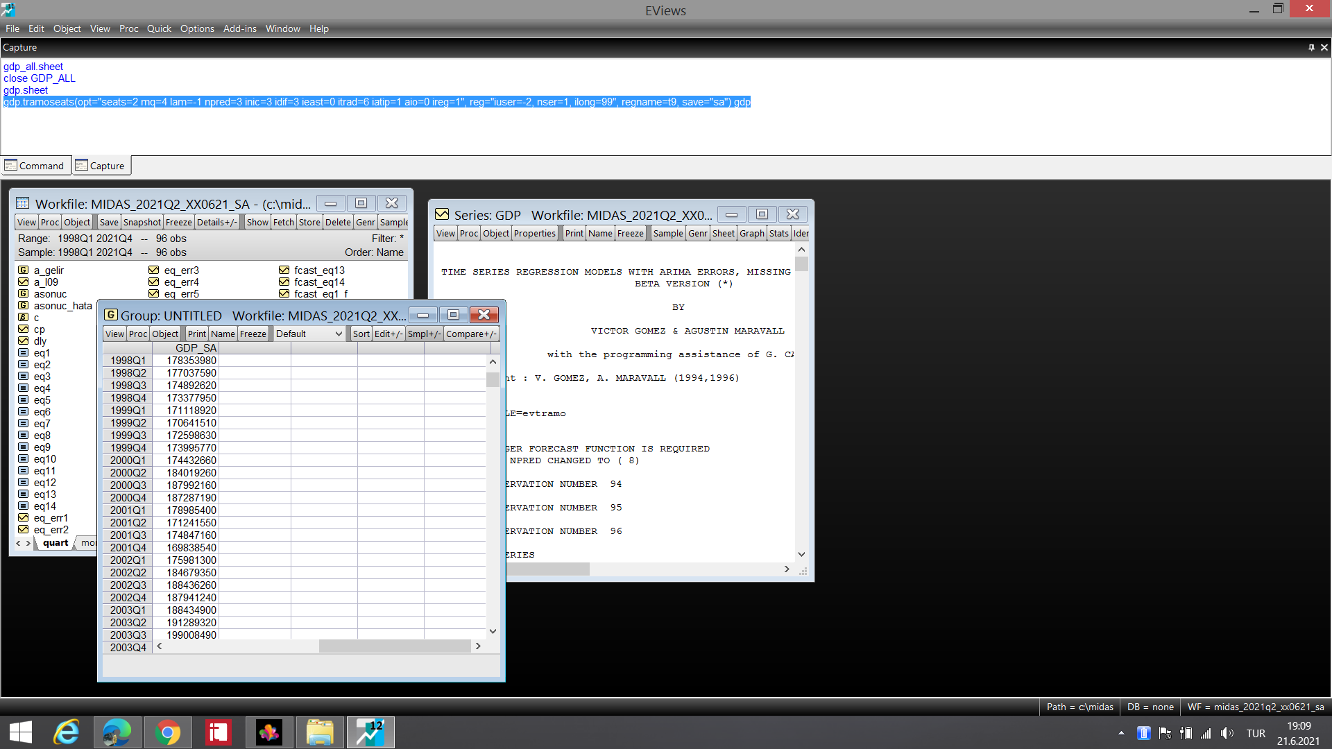

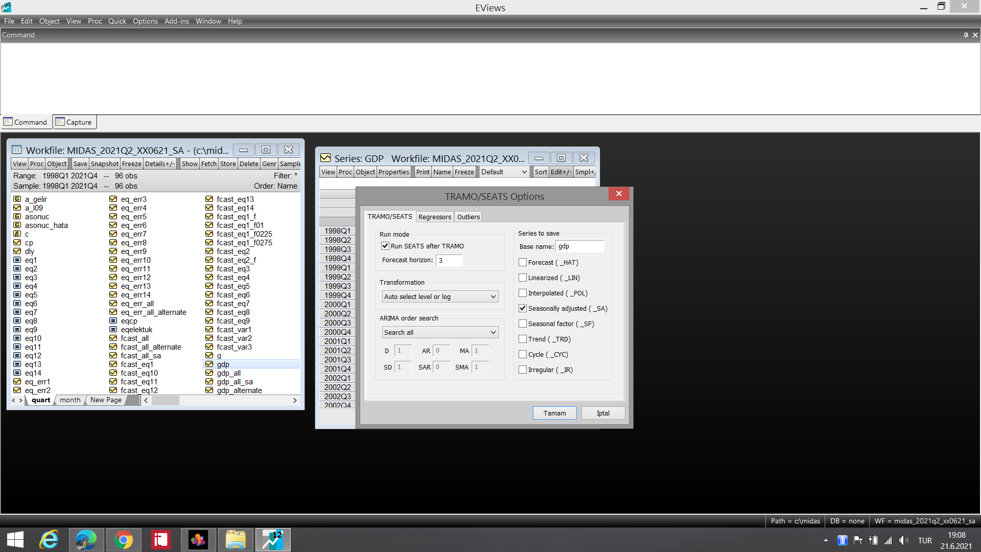

I have uploaded 3 screenshots here related to the Tramo/Seats options that I set via dialog. The 3rd screenshot contains the code that I obtain from the Capture section. I have specific user holiday series (named t9) in order to adjust for calendar effects. Even if Tramo/Seats works when I use the dialog box, it shows the error message when I run the program file consisting of only the related code.
On the other hand, when I untick the box for the trading day effect and try to adjust the series via the program file, it works.
- TramoSeatsOptions3.png (144.24 KiB) Viewed 10922 times
- TramoSeatsOptions2.png (130.96 KiB) Viewed 10922 times
- TramoSeatsOptions1.png (131.61 KiB) Viewed 10922 times
