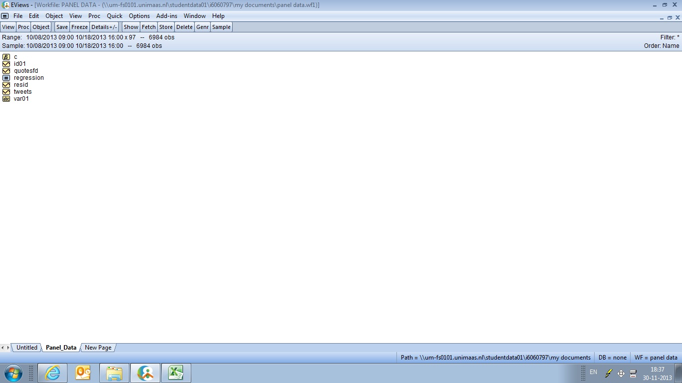

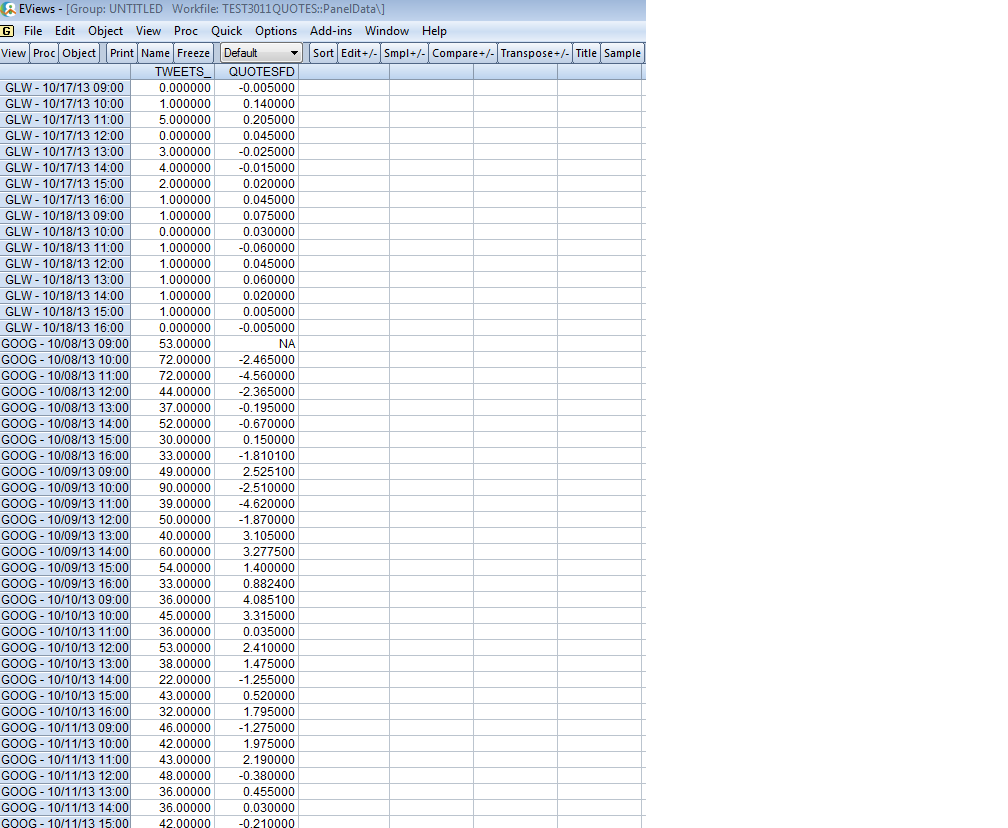

Dear Eviews users,
I'm also having problems creating a dummy in my panel data. In my Tweets and Quotesdf are the tweets of 98 stocks and the first differenced stock quotes. Now I want to establish a dummy for the Google tweets & stocks since I'm hoping that my data will then be normally distributed. Can someone help me? I already tried making a dummy but I didn't work.
Thanks in advance for your time, very much appreciated!

Re: Dummy Variables
Not quite sure what you're trying to do?
Just create a dummy whenever the stock name is "GOOG"?
series dum = 0
smpl if var01="GOOG"
dum = 1
smpl @all

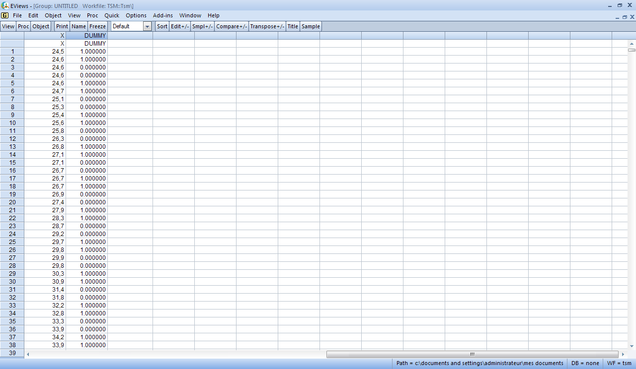

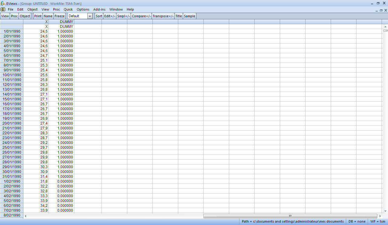

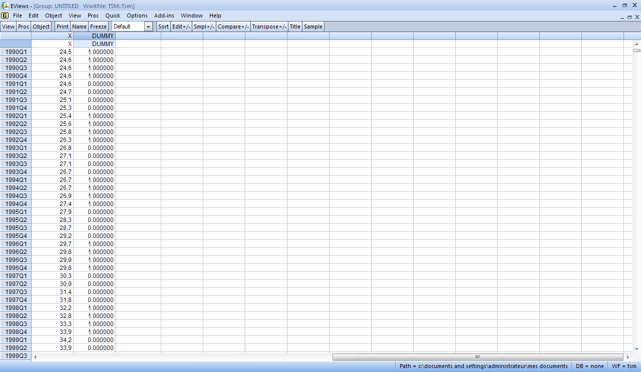

I would like to create dummy variable for 400 obs daily (7 day week) from 1990/01/01 to 04/02/1991.
1-a dummy variable eqaul to 1 for 01/01/1990 to 31/01/1990 and equal 1 for 01/03/1990 to 31/03/1990...etc, and for monthly and quarterly ...etc date.
2-a dummy variable for No-dated, dummy equal to 1 for 1 and 2 obs and 5 and 6 obs...etc.
best regrads.
best regrads.

Re: Dummy Variables
I have no idea, would you like to help me
best regards
best regards
Re: Dummy Variables
What have you done so far?
Re: Dummy Variables
for the moment I have no idea.
