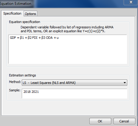

Hi, I was regressing a set of data in my model in Eviews applying OLS.
My model is: GDP = β1 + β2 FDI + β3 ODA + u
Yet, when I input the above model in Eviews, there was an error message: "GDP is not defined."
Do you know how to fix the above error so that I can run my model in Eviews for results?
Thank you.
Thank you.

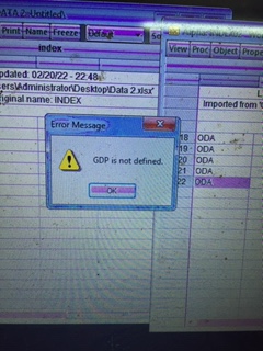

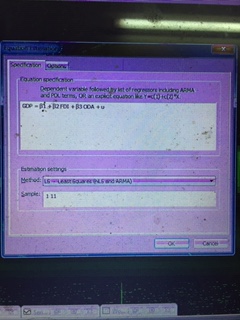

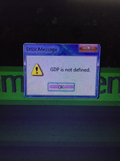

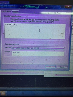

I input the above commands in Eviews.
Below are the screenshots.
It keeps showing the message that the variables are not defined.
How to fix these errors?
- IMG_6516.JPG (40.45 KiB) Viewed 12285 times
- IMG_6515.JPG (48.83 KiB) Viewed 12285 times
- IMG_6517.JPG (51.42 KiB) Viewed 12285 times
- Posts: 3798
Re: Error "Variable is not defined" in panel ARDL
Two things:
I believe your data isn't organized correctly. In your Excel file you probably want one column for GDP, another for FDI, etc.
Then in the estimation window just type in the list of variables, no coefficients. Include C to get an intercept.
Consider taking a look at the free EViews Illustrated.

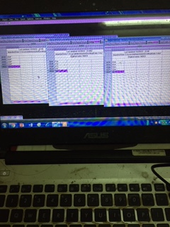

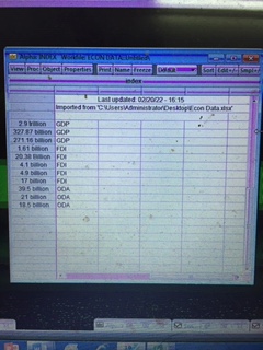

I tried to input another command with another excel file
Below are the screenshots of the command
Yet I saw the same error message that the variable is not defined
What does this error message mean?
I looked at some tutorials yet they did not mention this case.
I am using a Demo version of Eviews. Is it because it is a Demo version so the above error appeared?
Thanks.
Thanks.
- IMG_6523.JPG (55.13 KiB) Viewed 12273 times
- IMG_6522.JPG (50 KiB) Viewed 12273 times
- IMG_6521.JPG (54.68 KiB) Viewed 12273 times
- Posts: 3798
Your Excel spreadsheet should have one column for each variable. The first row should be the variable name and the entries below that should be the data. Look at Chapter 2 of EViews Illustrated. Or it might be just as easy to enter the data directly in EViews.
Please don't post photos of your screen. They are too hard to read. Post a screenshot taken on the computer.

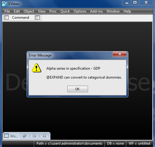

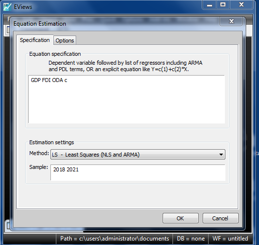

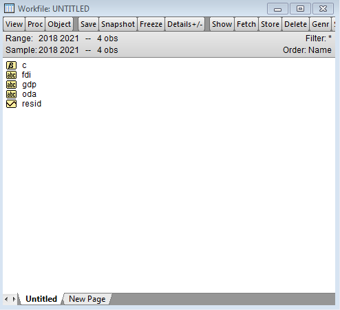

I applied another Excel spreadsheet and input a new command on Eviews with only the variables and the constant.
Yet there was an error message:
"Alpha series in specification - GDP
@EXPAND can convert to catagorical dummies."
What does the above error mean and how to fix it?
Below are the screenshots. Thanks.

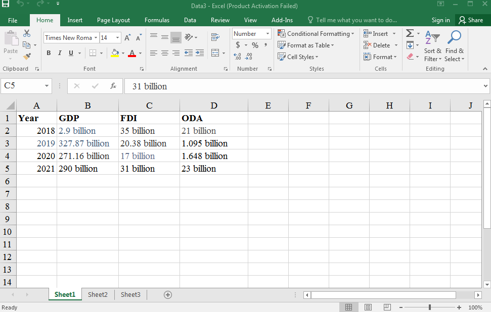

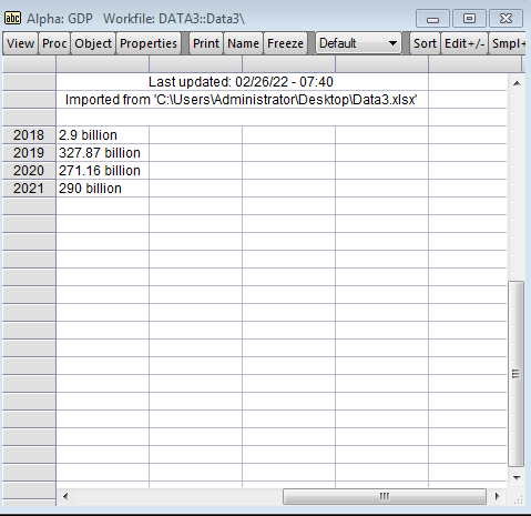

- 5.png (15.57 KiB) Viewed 12191 times
- 4.png (60.07 KiB) Viewed 12191 times
- 3.png (77.8 KiB) Viewed 12191 times
- Posts: 13608
The gdp data contains characters, not numbers
Do you mean the data can contain only characters but not the figures?
Attached are the data that I applied in this Eviews command.
There appeared the error message like above. Pls advise. Thks.
