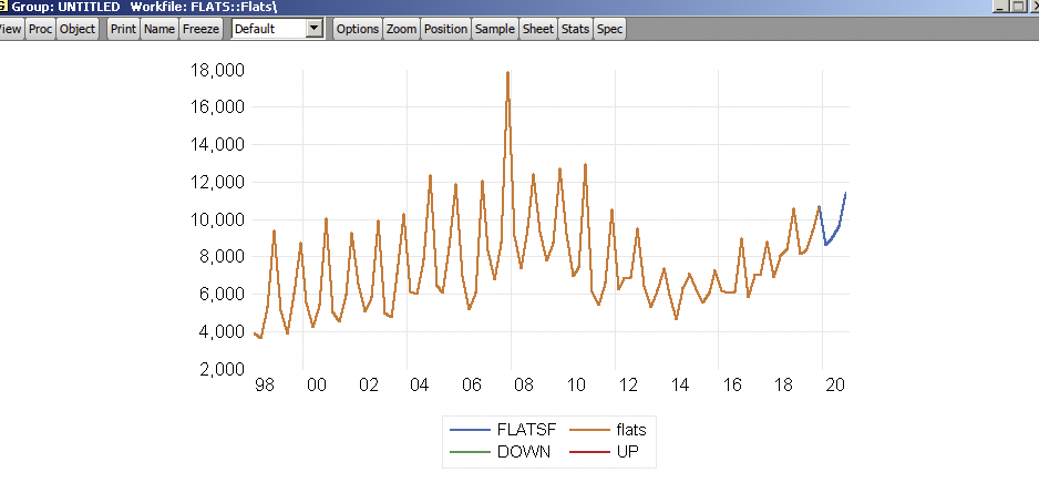

This is final prediction. The interval boundaries are also written in the legend, but they simply do not appear. The weird thing is that if I try a deterministic model on the same set, they will show up in that picture. But once I estimate the stochastic model and specify that the GLS method be used, it simply doesn't work.

Sorry, you're not being very clear. Your image shows a group. What's that group? Where did it come from? What's the output of the forecast?

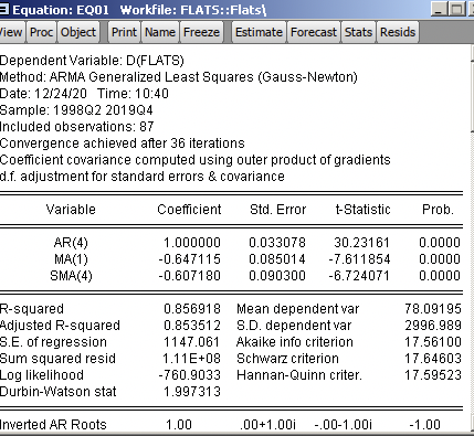

I am not really sure about what you mean. Here is the estimation output. In the picture there is a group consists of : forecast of number of flats, the original variable and the upper and lower limits of the confidence interval. Original variable comes from an excel file on my computer, flatsf is prediction created in eviews as well as limits of the interval by entering the command: series down=flatsf-1.96*se and series up=flatsf+1.96*se.

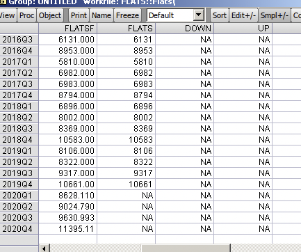

Alright, after several hours of desperate searching for reason, I probably found why is that happening.when I don't leave the item coef. uncertainty selected, so the intervals are finally displayed. But my friend has the same version of the program and does not have to do this. Could it be because of some update?
*different file but also a stochastic model
