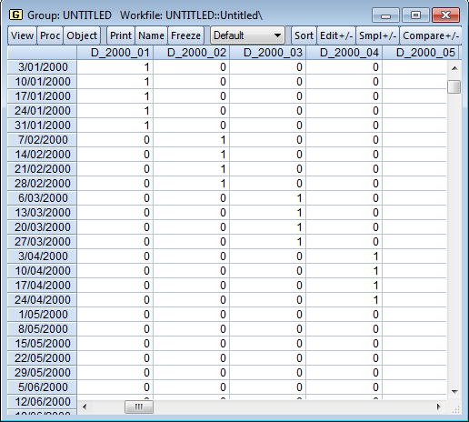

clubmed
Posts: 81
Joined: Sun Nov 30, 2014 3:03 am
Re: rename dummy and diagonal dummy
Postby clubmed » Sat Apr 01, 2017 3:21 pm
1/Do you mean the number of week in year. ( some year have 52 week and some year have 53 week)
the program doesn't create number zero at left, and generate
create w 03/01/2000 28/12/2015 for !y=2000 to 2001 %y = @str(!y) if !y<10 then %y = "0"+%y endif for !w=1 to 53 %w=@str(!w) if !w<10 then %w="0"+%w endif series d_{%y}_{!w} = @recode(@year=!y and @datepart(@date, "ww")=!w, 1, 0) next next
2/ for the interday i have the same problem.
wfcreate 30min(Mon-Fri,8:00-9:00) 01/01/2000 31/12/2001 for !i=1 to 1563 %i = @str(!i) if %i<10 then %i="0"+%i endif if %i>=10 and %i<100 then %i="0"+%i endif if %i>=100 and %i<1000 then %i="0"+%i endif series d_{!i}=@recode(@trend+1=!i,1,0) next
3/ is there a way to put the date "@date" in the name of series d_{.._.._..} for any frequency (the date associated with a single observation dummy).
:cry:
Postby EViews Gareth » Sun Apr 02, 2017 7:54 pm
I'm asking how you define which month a week is in.
If you assume that weeks start on a Sunday and the 31st of March is a Sunday, which month is that week in? March (where only the Sunday is actually in March) or April?
If the 31st March is a Wednesday, which month is that week in? March or April (half the week is actually in one month and half in the other).
Weeks don't line up with months. So you have to decide how you want to allocate them. Mathematically.
And of course you have to take into account that they will differ year to year. Week 5 may be in January one year and February the next.
clubmed
Posts: 81
Postby clubmed » Mon Apr 03, 2017 11:59 am
1/you are right, if i run the code below it generate all dummy, and i have generate three series:
series f1=@year
series f2=@month
series f3=@day
f1(1)=2000
f2(1)=1
f3(1)=3
how can rename all series dummy by each value in the series f1 f1 f3 like this: d_(f1(1))_(f2(1))_(f3(1))_001, d_(f1(2))_(f2(2))_(f3(2))_002....etc

EViews Matt
Posts: 592
Postby EViews Matt » Mon Apr 03, 2017 2:50 pm
Given all the date irregularities, perhaps it would be simpler to build the dummy series' names as a custom date format, e.g.,
for !i = 1 to @obsrange %tmp = @datestr(@dateval(@otod(!i)), "YYYY_MM_DD") series d_{%tmp} = @obsid = !i next
The format string "YYYY_MM_DD" can be easily changed for any desired frequency.

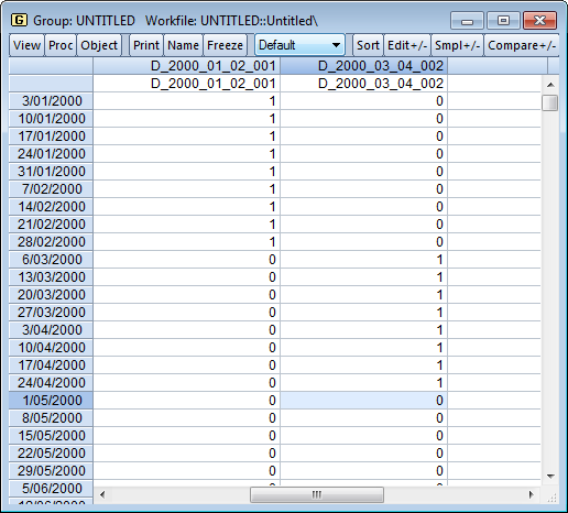

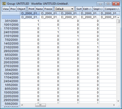

1/ i have made a modofication to your code with this:
by two month:
%format = "YYYY_MM"
for !i = 1 to @mod(@obsrange,2)
to gives me by two month ( or by 4 month by 6 month) and rename it d_{year}_{1st month}_{2nd month}_01, d_{year}_{3st month}_{4nd month}_02,...etc, it doesn't work.
by two week:
%format = "YYYY_MM_DD"
and rename it d_{001}
it doesn't work. are there a solution to make dummy by two month or 4 month or 6 month, and by 2 week or 3 week or by 4 week or by 5 week.
i need this:
by two week.png (31.51 KiB) Viewed 15993 times
by two month.png (34.08 KiB) Viewed 15993 times
EViews Matt
Posts: 592
Postby EViews Matt » Wed Apr 05, 2017 10:13 am
The code I suggested exploits EViews' date format capabilities, and so is convenient only when the desired frequency maps easily to a date. It's not impossible to use other frequencies, e.g., every two months, but more extensive modifications to the code would be required. In such cases, you're probably better off using the nested loop strategy you began with. For example, dummies for two month periods:
for !i = 2000 to 2015 %year = @str(!i) for !j = 1 to 12 step 2 %month1 = @str(!j, "i02") %month2 = @str(!j + 1, "i02") series d_{%year}_{%month1}_{%month2} = @year = !i and @month >= !j and @month <= !j + 1 next next

A two-, three-, etc., week dummies is a little trickier, since there isn't a @week function like there is for @year and @month, but @datepart and/or @datediff can be used instead.
clubmed
Posts: 81
Postby clubmed » Wed Apr 05, 2017 2:26 pm
Works perfectly.
The series d_2000_001=@datepart(@date,"ww")<=2 it generate dummy for the 1st and 2nd week of month Jan for every year ( for the first and second week of Jan 2000 and the first and second week Jan 2001 ..etc in same series d_{2000}_{001}), and i don't know how to use the combination of the function @datepart and @datediff, could you solve this.
EViews Matt
Posts: 592
Postby EViews Matt » Wed Apr 05, 2017 3:30 pm
It occurs to me you probably want the week dummies to cross year boundaries, e.g., for dummies spanning 5 weeks there will be a dummy covering part of 2000 and 2001 (weeks 51-55). It's probably easier to go back to an observation driven loop in that case, like the format string examples, but instead of using a format string use another identifier that is unique to each dummy (based on how many weeks have passed since the beginning of the sample). For example,
!size = 3 'how many weeks per dummy !first_date_number = @dateval(@otod(1)) for !i = 1 to @obsrange !week = @datediff(@dateval(@otod(!i)), !first_date_number, "ww") !id = @floor(!week / !size) + 1 %series_name = "d_" + @str(!id, "i03") if not @isobject(%series_name) then series {%series_name} = @floor(@datediff(@date, !first_date_number, "ww") / !size) + 1 = !id endif next
