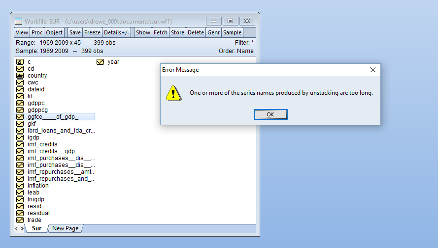

Postby drewesparon » Mon Jun 13, 2016 12:33 pm
i tried it but i keep getting an error message
Re: Converting
Postby EViews Gareth » Mon Jun 13, 2016 12:34 pm
Ah, yes. Delete the series with long names (or rename them if you need them).
