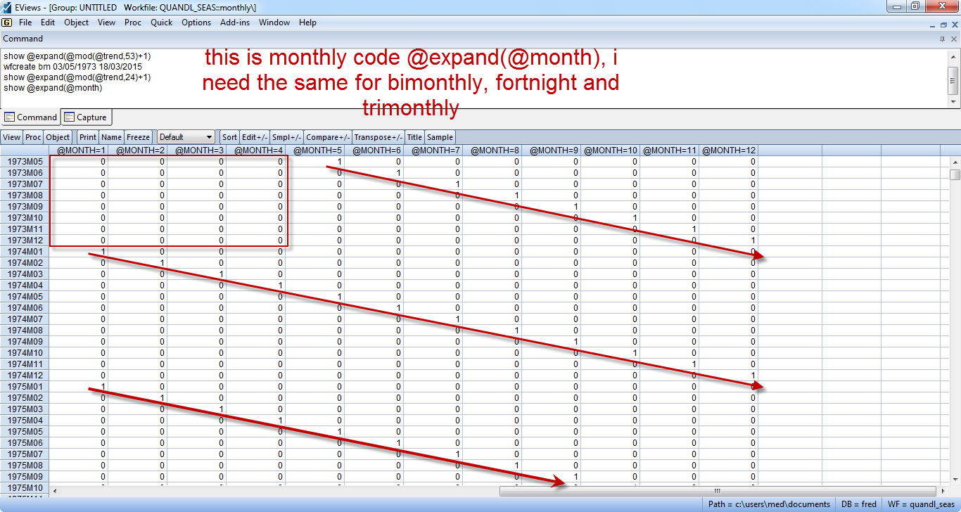

Re: seas dummy bimonthly s=24, fortnight s=26...
yes, but for the monthly data it make regular dummy:
1973m5 = @month=5 take 1
1973m6= @month=6 take 1
...etc
why for bimonthly not? s=26 it should start from 5th month ( the 1st bimonthly of May)
...etc
i hope that you understand me
- 22-03-2016 19-25-22.png (135.23 KiB) Viewed 12936 times
I understand what you're saying. I'm telling you you are wrong.
