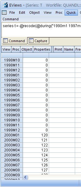

this code generate trend for period 1990m1 1997m6 (trend take 0 1 2 3.....89), but from 2000m1 2002m12 it take this value 120 121 122.....155.
i would like this:
from 1990m1 1997m6 take 1 2 3 4....
from 2000m1 2002m12 take 1 2 3 4....
other period take 0
series t = @recode(@during("1990m1 1997m6") or @during("2000m1 2002m12"), @trend, 0)

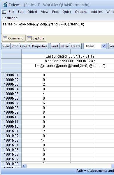

the second code generate trend like this 0 0 2 0 4....i would like this
from 1990m1 1990m12 take 1 2 3 ... 12
from 1991m1 1991m12 take 0
from 1992m1 1992m12 take 1 2 3 ...12
from 1993m1 1993m12 take 0
and so on
series t = @recode(@mod(@trend,2)=0, @trend, 0)

1st code:
when i substruct 119
from period "1990m1 1997m6" trend will be this -119 -118 -197....-30.
from period "2000m1 2002m12" the code work. trend take 1 2 3....36.
series t = @recode(@during("1990m1 1997m6") or @during("2000m1 2002m12"), @trend-119, 0)
but if i use this code
from period "1990m1 1997m6" the trend will be this 0 1 2 3....89.
from period "2000m1 2002m12"the trend will be this 120 121....155.
i need this:
from 1997m7 1999m12 take 0
and all other period take 0
2nd code:
if i divided by 2
the first year will be this: 1st month take 0, second take 0, 3rd take 1, 4th take 0, 2, 0, 3, 0, 4, 0, 5.....and so on
series t = @recode(@mod(@trend,2)=0, @trend/2, 0)

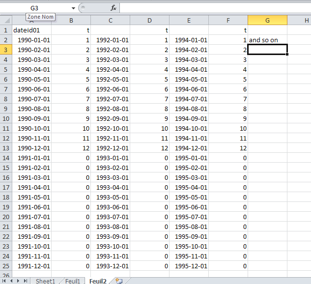

i need this:
1st year: 1990m1 1990m12 take 1 2 3 ... 12
2nd year: 1991m1 1991m12 take 0
3rd year: 1992m1 1992m12 take 1 2 3 ...12
4th year: 1993m1 1993m12 take 0
and so on

2nd code:
the new code i have change @trend by @year because i have monthly data.
series t = @recode(@mod(@year,2)=0, @trend+1, 0)
but here
1st year take value from 1 to 12, 2nd year take value 0, 3rd year take value from 25 to 36 (it should take value from 1 to 12), 4th year take 0 (and 5th year sould take value from 1 to 12) and so on.
i need this: year (1990 1992 1994 1996....) take trend from 1 to 12 for every year, and year (1991 1993 1995....) take 0. even and odd
i will use smpl date1 date2 for every year to make trend.
have you an idea about the 1st and 2nd code.
