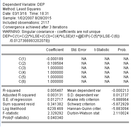

Hi all, I encountered this problem while running my model: std error, t-statistic and Prob. returned NA and I really don't understand why. Here I attach my result screenshot and data workfile in case you can help me check. Thanks in advance.

Postby startz » Sun Mar 13, 2016 8:26 am
You probably have bad starting values in the C vector.

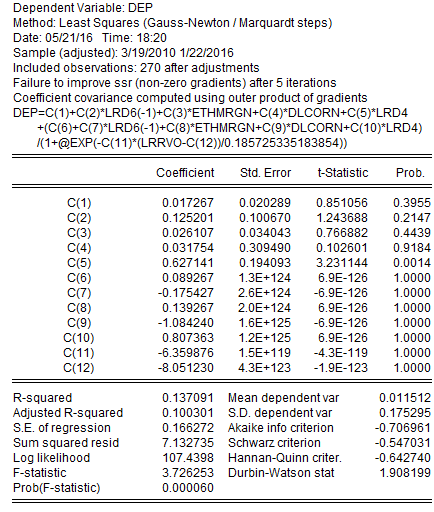

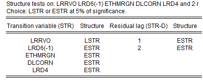

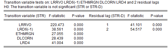

I am having a problem with estimation. I have tried changing my starting values and I can't seem to resolve the problem here. Here is an upload of my output. But what is strange is that the transition variable I am using has some very strong results in the tests for significance. Also it seems I am correct in estimating an LSTR, as indicated by the structure tests.
However there is clearly something wrong with my standard errors, t-stats and p-values. Do you have any idea how I might resolve this issue?

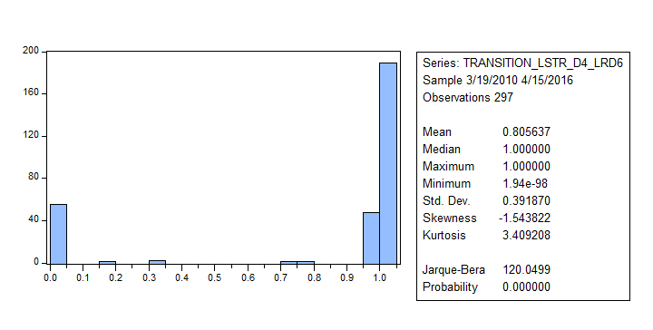

Maybe. To check how your transition function behaves you can select the option "Evaluation of the transition function" and this will give you the values that your transition function takes. If the function only takes two values then you will have a TAR model. Do you want the model to calculate forecasts? or for what purpose?
Best regards,
It does appear to take on more than two values. Primarily I am not interested in forecasting, but rather in explaining observed patterns in two time series. For example I have two time series which have exhibited a coupling behavior over some time, meaning they nearly converged in value. My theory is that this coupling pattern was triggered by an exogenous observed variable crossing some threshold. So I guess my interests lie in model selection primarily, because I'd like to argue that some particular transition/threshold variable is the most significant variable in determining the regime change.

I looks like that the optimization algorithm does not reach convergence. You can try different strarting values. When I have no idea what values, what I usually do is to try random numbers for the starting values and I keep the ones that reach the best values of some criteria (BIC, AIC, R2,SSR). If this does not work you can change the convergence parameter of the optimization algorithm, the default can be changed in Options->General Options->Estimation Options.
For what I can see the model does not differ to much from a TAR. You can graph the transition function and the two time series over the same axis to see if the transition variable explains the divergence between the series.
