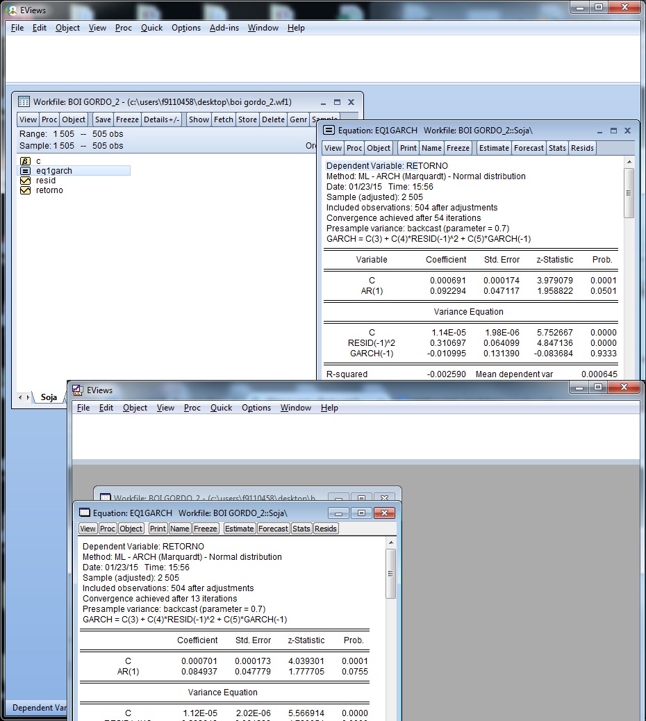

Another doubt I have: when running GARCH on Eviews 8, I´m obtaining results that are different than running it on EViews 6. So far, the only difference I could notice is that on EViews 8 the results are obtained after 54 iterations, and on EViews 6 are obtained after 13 iterations, as seen on the file attached.
I´ve checked all the options and did´nt found any configuration differences between those files. Does anybody knows what may be happening?
Thanks again!!!

Probably just improved algorithms between 6 and 8.
