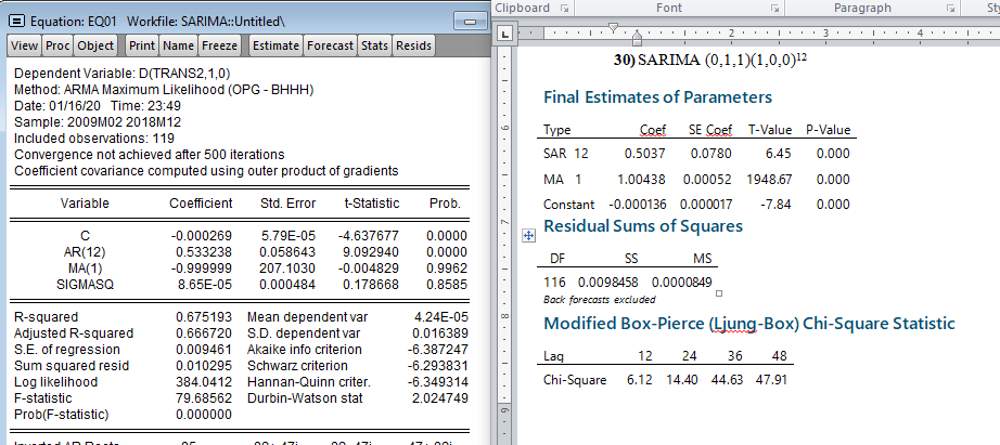

How to represent SARIMA (0,1,1) (1,0,0)12 in eviews?
I have tried d(transinflow,1,0) c ma(1) sar (12) but the results are very different from Minitab, even the parameters that appear in eviews are not SAR but AR. Can anyone tell me where is my fault?
the left side uses eviews, and the right side uses minitab
Annotation 2020-01-21 234521.png (59.89 KiB) Viewed 9569 times
