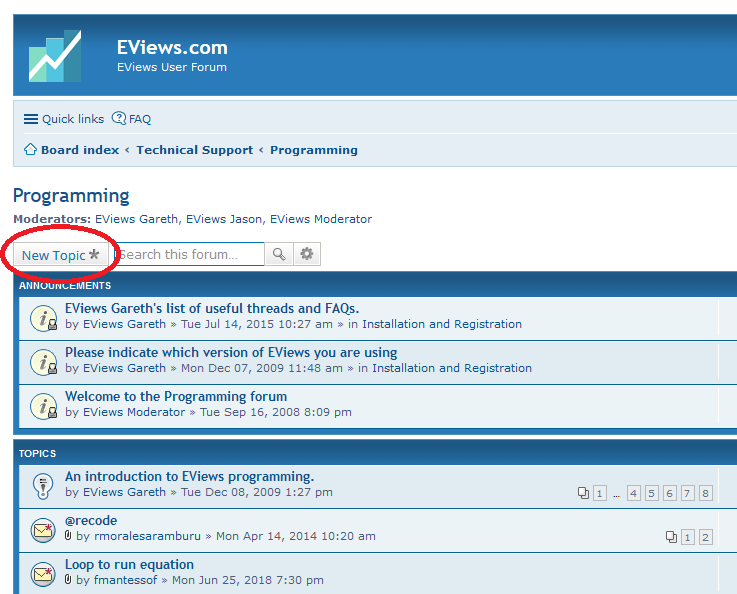

By the way, i can't find the place to post my own question, could you show me?

When you're on the topic list page for a board, just press the "New Topic" button. This button is located near both the top (shown below) and bottom of the page.
