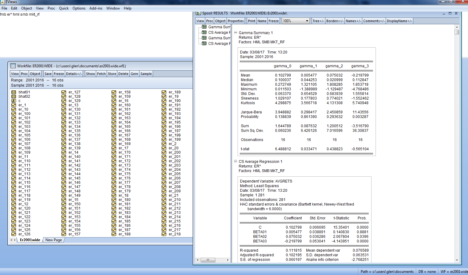

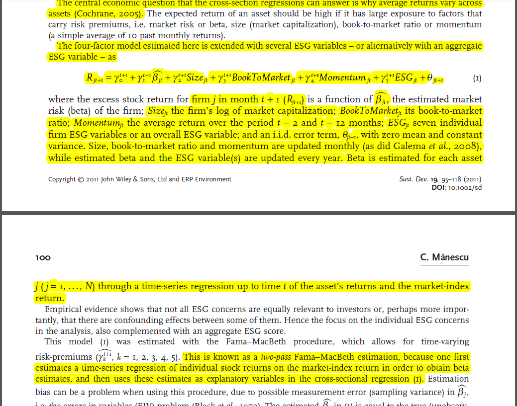

I am asking if the risk-factors can be a matrix?
I have added my own stock returns into the fm_example workspace. My files are called er_01, er_02 etc. I can then perform the FMB regression: fmb er* hml smb mkt_rf. Because the risk factors (hml, smb, mkt_rf) are fixed for all dependent variables, er* is therefore regressed against fixed risk factors.
Is it possible to change the risk factors so that they are in matrix form? So that every er_# is regressed against its corresponding value, size and market beta?
I have attached the explanation in the academic paper that explains the use of firm-specific independent factors, and also proof of my FMB regression output with the K.French factors. This might help explain my confusion.

If you are asking whether you can force the addin to perform Fama-MacBeth on multiple sets of risk factors at the same time, the answer is no. Fama-MacBeth examines the risk premia from exposure to a common set of factors, not different factors for each return series. I suspect there is something you are not understanding about your problem.

In Fama & French (1992) "The Cross-Section of Expected Stock Returns" they seem to use multiple sets of risk factors for each return series. Is this correct?
Are you saying the add-in can only perform and replicate the Fama & French (1993) paper "Common Risk Factors...", using common risk factors (SMB, HML)?
Therefore, I cannot use firm-specific risk factors in this add-in. Correct?
