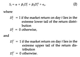

I'm new to EViews, so apologies in advance if any of this is unclear. I'm in the midst of writing a finance dissertation, and need to run regressions with two dummy variables for some of my research.
I have the following series uploaded into EViews, all of which are sorted by the same dates (a 15 year daily time series): the daily average return of my sample, the daily dispersion of the returns measured using one method, and the daily dispersion of returns measured using a second method.
I want to determine whether, on days when the average/market return is extreme (top/bottom 1% or 5% of returns), dispersion increases or decreases (this is where two dummy variables comes into play), and how this differs for the two methods. I will run two separate regressions, one for each measure of dispersion. I've attached a picture of what my regression equation needs to look like (with an explanation of the dummy variables):
I will want to run the regressions at least twice, with the 'extreme lower tail' being tested at both the 1st and 5th percentile, potentially 10th as well. S(t) in the equation attached is the level of dispersion corresponding to the same day as the return.
Is anyone able to help me figure out how to do so? It doesn't seem like it should be too complicated but I'm just not sure where/how to start. Sorry this is so long, but thanks for any help.
EViews Matt
Posts: 592
Re: Dummy Variables
Postby EViews Matt » Thu Aug 09, 2018 9:09 am
You should be able to create your desired dummy variables using variations of the following command. This example command creates a dummy for the extreme low returns at the 5% threshold (daily average returns in series x),
series D_L_05 = @ranks(x) / @obssmpl < .05
