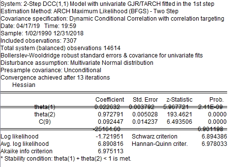

Can someone help me please? What is this line upon the theta(1) coefficient. Also what is this number below C(9)? It has no description neither does it clarify to what it responds. Finally, what is C(9). Are they lags? Please I need your help since it is the first time that I ever met such a thing. You can see what I mean in the file that I attached below.
Dcc_Garch_Eviews
