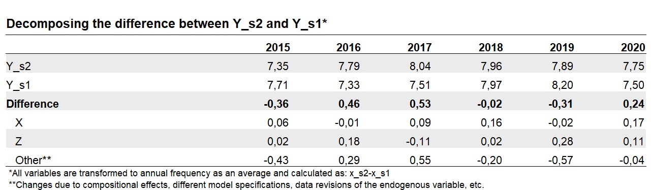

The following example demonstrates this decomposition method. The attached program initializes a quarterly workfile and simulates a Data Generating Process (DGP) in which regressors x and z follow stochastic trends and drive y via a linear relationship with Gaussian noise. The script generates these series over three iterations, producing distinct sets for actual data and two scenarios, before isolating the 'actual' set for estimation. Subsequently, the code fits an OLS regression to recover the underlying parameters, incorporates the resulting equation into a model object, and creates an empty spool object for output.
Finally, it invokes the decomposition routine (decompose_single_spec.prg), which attributes the change in y to the specific contributions of x, z, and the residual term. This routine derives the decomposition by running multiple simulations on an auxiliary model object, yielding the table below.
Although decompose_single_spec.prg allows for general application by accepting a model object and scenarios, a built-in implementation would be more efficient. It should also be noted that the current routine is limited to single-equation decomposition. A truly general routine would extend this logic to the full model, decomposing endogenous variables into the contributions of exogenous drivers.
Skjermbilde 2025-12-27 093108.jpg (103.54 KiB) Viewed 18484 times
close @all rndseed 1234 wfcreate q 2000 2020 'construct variables (and scenarios) for %s _s1 _s2 _act genr x{%s}=5+0.5*nrnd+0.08*@trend genr z{%s}=10+0.3*nrnd+0.06*@trend genr y{%s}=7+0.6*x{%s}-0.4*z{%s}+0.6*nrnd next rename *_act * 'generate actuals, remove suffix 'estimate equation equation my.ls y c z x 'make model-object model m m.merge my 'make spool object spool s 'decompose changes between the two scenarios (and append result to spool object) smpl 2015 2020 exec .\decompose_single_spec(model=m, spool=s, variable=y) _s1 _s2 show s

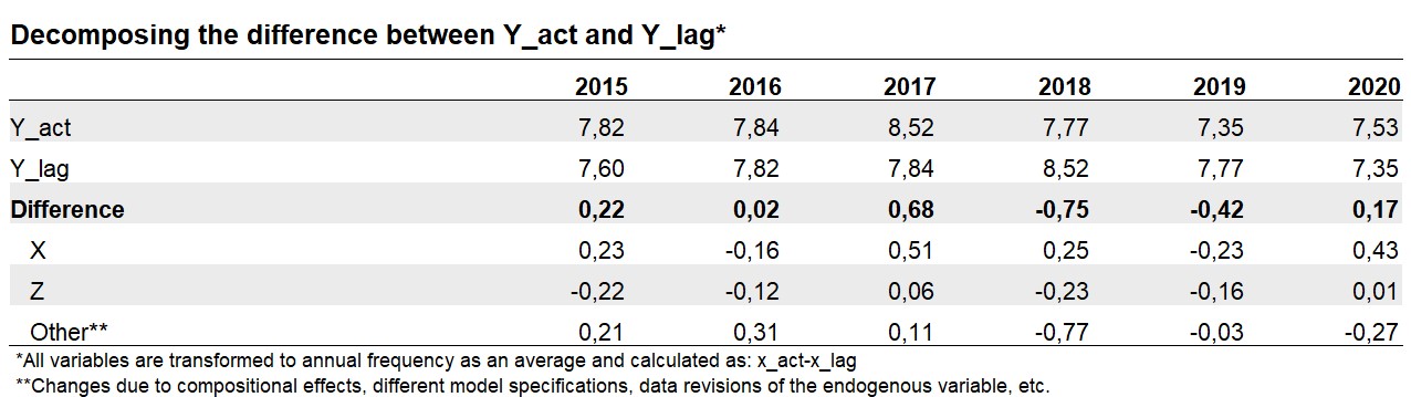

Note that by defining the comparison scenario as t-1, the decomposition can be used to analyse the contributions to the change in the variable over time, e.g.:
smpl @first+4 @last for %v y z x genr {%v}_lag={%v}_act(-4) next smpl 2015 2020 exec .\decompose_single_spec(model=m, spool=s, variable=y) _lag _act show s
which yields the table:
