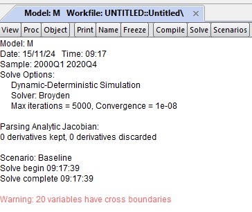

Postby tvonbrasch » Fri Nov 15, 2024 1:45 am
when running the code:
wfcreate q 2000 2020 model m for !i=1 to 10 m.append x{!i}=100+@trend m.append y{!i}=100 %setbounds= %setbounds+" x"+ @str(!i)+"(1,110)"+" y"+ @str(!i)+"(1,110)" next m.setbounds {%setbounds} m.msg m.solve
why does the error message read: "Warning: 20 variables have cross boundaries"
and not "Warning: 10 variables have cross boundaries" ?
Is this a bug?
