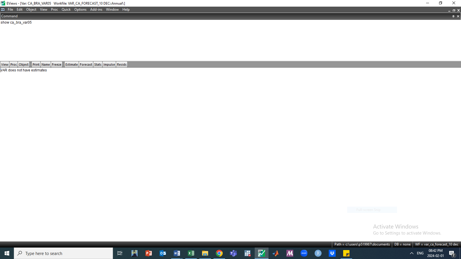

I appreciate your timely responses, but I still get the same result. Kindly see the attached screenshot.
- BTVC.PNG (76.27 KiB) Viewed 40062 times
Re: estimating the the BTVC-VAR model.
Btvcvars are only available in EViews 13
Dear Gareth,
It turns out that the issue is that I am using Eviews 11, and BTVC is a new edition in Eviews 13.
Thanks again.
Thanks again.
Yes, I just realised now.Btvcvars are only available in EViews 13
