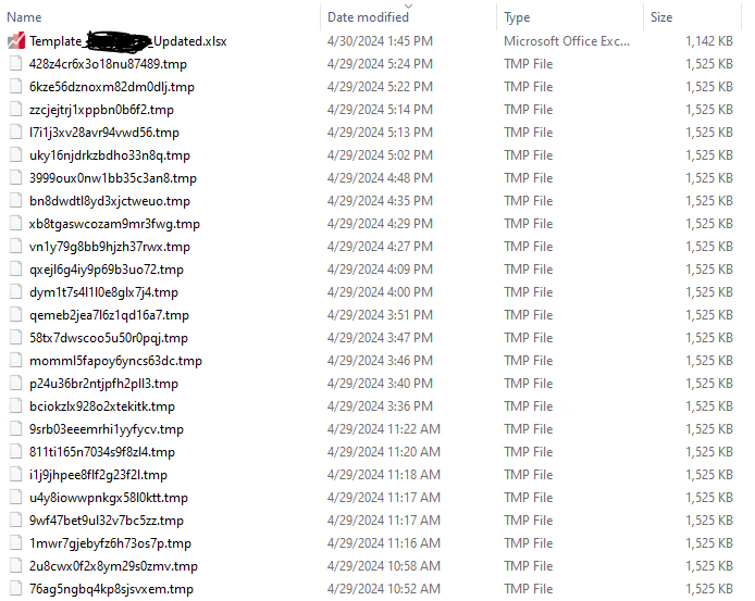

We are having an issue when running programs in EViews 13 that read multiple sheets from an Excel workbook. I think this only happens when we also have the file open in Excel. First, we are seeing that multiple tmp files get produced (see screenshot), which appear to be backup copies of the original excel file. But very occasionally this seems to cause an EViews crash, which results in deletion of the xlsx file. We have no such issue with EViews 12. If this isn't a known issue and you need more info, let me know.

It is occurring with many different files where we are reading from multiple tabs. I suspect but not 100% sure that it only (or at least more frequently) happens if we simultaneously have the file open in Excel. For context, these are input sheets that we are using to create a large-scale forecast model.
Re: Excel Corruption Issue (EViews 13, windows)
Postby EViews Gareth » Tue Apr 30, 2024 4:36 pm
It is probably related to Excel being open, yes. If Excel is open, we ask Excel to handle the file read. If Excel is closed, EViews does it. (Roughly).
We'll poke around, but in the meantime recommend having Excel closed.
