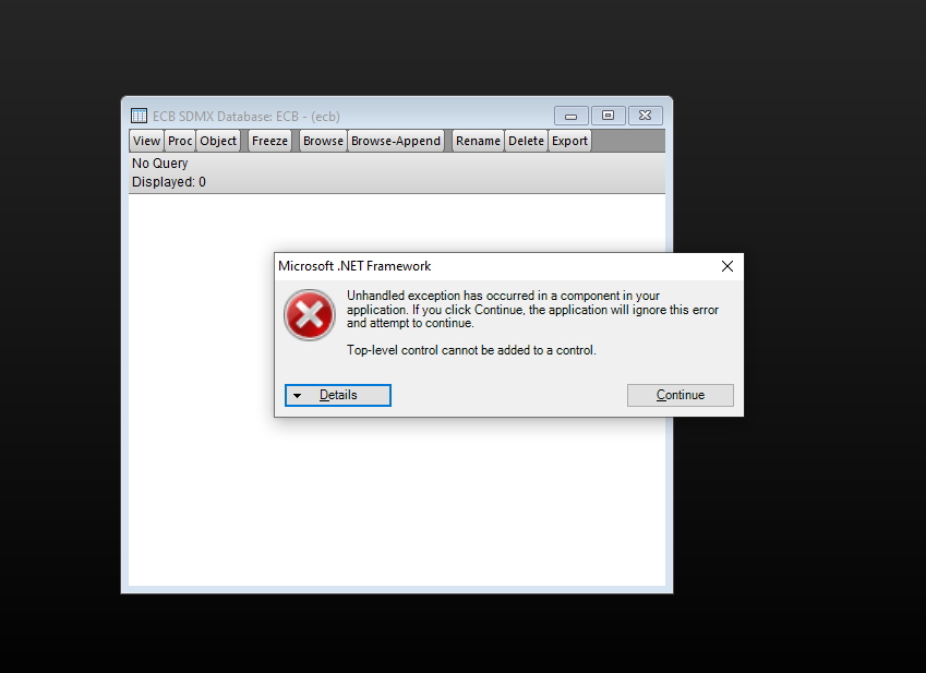

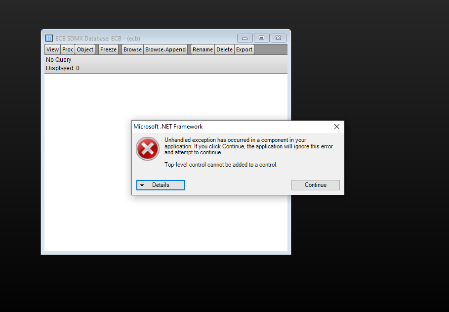

On any request for data from ECB database, I obtain the following issue (below).
Is this problem on my side or this is common problem? Does ECB database work on your side?

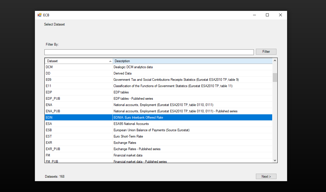

I can press "Browse" and I see datasets, but then I choose any database and press "Next", and then error occurs...
I use Eviews 11 with the latest patch, Dec 8 2020 build.

Latest patches of EViews 11 (Build date Dec 14 2020 or later) contain fix for the issue.
