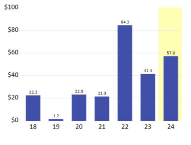

Attached are simplified versions of my programs/workfiles. I do notice that when I increase the range of my shading (from 1 year shaded to 2 years) it will include the shading, but it is offset from the beginning of the bar in the year that I would like the shading to begin. I would like the shading to be in line with the bars if possible.

Re: Mixed Chart Graph Details
Ah, the issue is that your workfile is annual. You cannot shade a single observation.
Is that something that is unique to the mixed chart graphic? I was able to shade one observation when I was only using the bar chart.
- Screenshot 2023-08-25 151652.png (14.13 KiB) Viewed 26093 times
Its something unique to bar charts ;)
