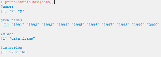

Take a close look at the "both" data.frame in R and inspect it's attributes. You'll see that it has "$row.names", "$names", and "$is.series" attributes that help EViews understand what each column is.
