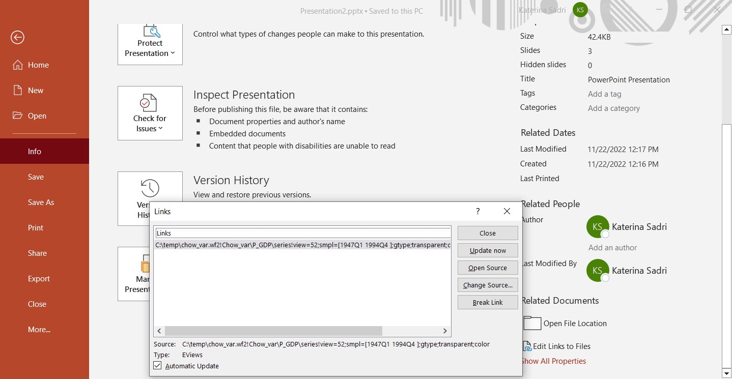

Postby EViews Katerina » Tue Nov 29, 2022 11:48 am
You can verify if your link (EViews work file location and object) is still valid by doing the following:
1.On Powerpoint open your file
2.On the menu click : File
3.On the left pane click : Info
4.On the bottom of right pane click : Edit links to files
5.You can check if the link is still valid by clicking update link.
I am attaching a screen shot of a link I created.
