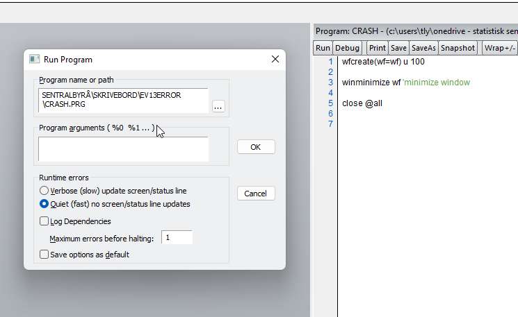

To generate the crash, I open a program with these commands:
wfcreate(wf=wf) u 100 winminimize wf 'minimize window close @all
Then I manually click on run and OK (quiet mode):
2022-09-13 11_25_03-EViews.png (36.48 KiB) Viewed 3636 times
It runs okay the first time, but when executing this code in this manual procedure once more (clicking on run etc), then EViews crashes ...
