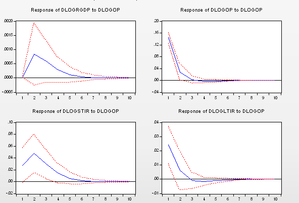

Thank you for your answer. I'm still a little bit confused about it. So can I ask you to give me an example based one these impulse responses? Thanks

dlogrgdp to dlogop: impulse responses are insignificant for all periods
dlogop to dlogop: impulse responses are significant for 1st period (impact period)
dlogstir to dlogop: impulse responses are significant for 2nd period
dlogltir to dlogop: impulse responses are significant for 1st period (impact period)

Thank you so much!
