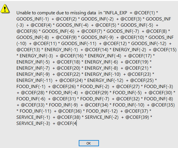

I encountered this problem when using bvar though I don't think I have missing data. I attached the workfile and the program
Thanks very much for your help

A lot of your variables having missing data for various dates, which is confounded by the number of lags you have in the model.
