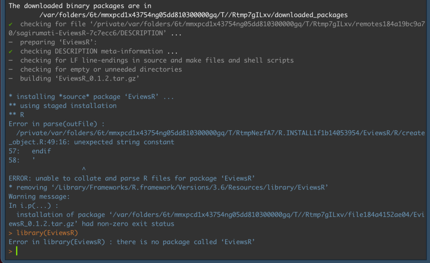

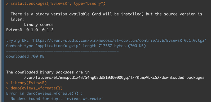

I installed the binary version of your library (v 0.1.0) since the source version was giving me a script error during package install.
Here's the error:

Re: EviewsR: test R package on macOS
Postby sagirumati » Thu May 19, 2022 10:09 am
Macbook Pro (2017 running Intel i7)
MacOS Big Sur (11.0.1)
RStudio v2022.02.2 Build 485
R v3.6.3
Here's the error:
Thank you for your efforts. EviewsR version 0.1.0 works on Windows only. Please install the development version from github and try again as follows:

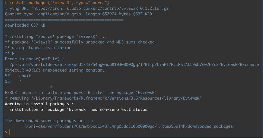

Postby EViews Steve » Thu May 19, 2022 2:10 pm
Here's the error from the source version:
install source error.png (132.84 KiB) Viewed 9445 times
Postby EViews Steve » Thu May 19, 2022 2:16 pm
Tried your install_github call, and got a similar error as before:

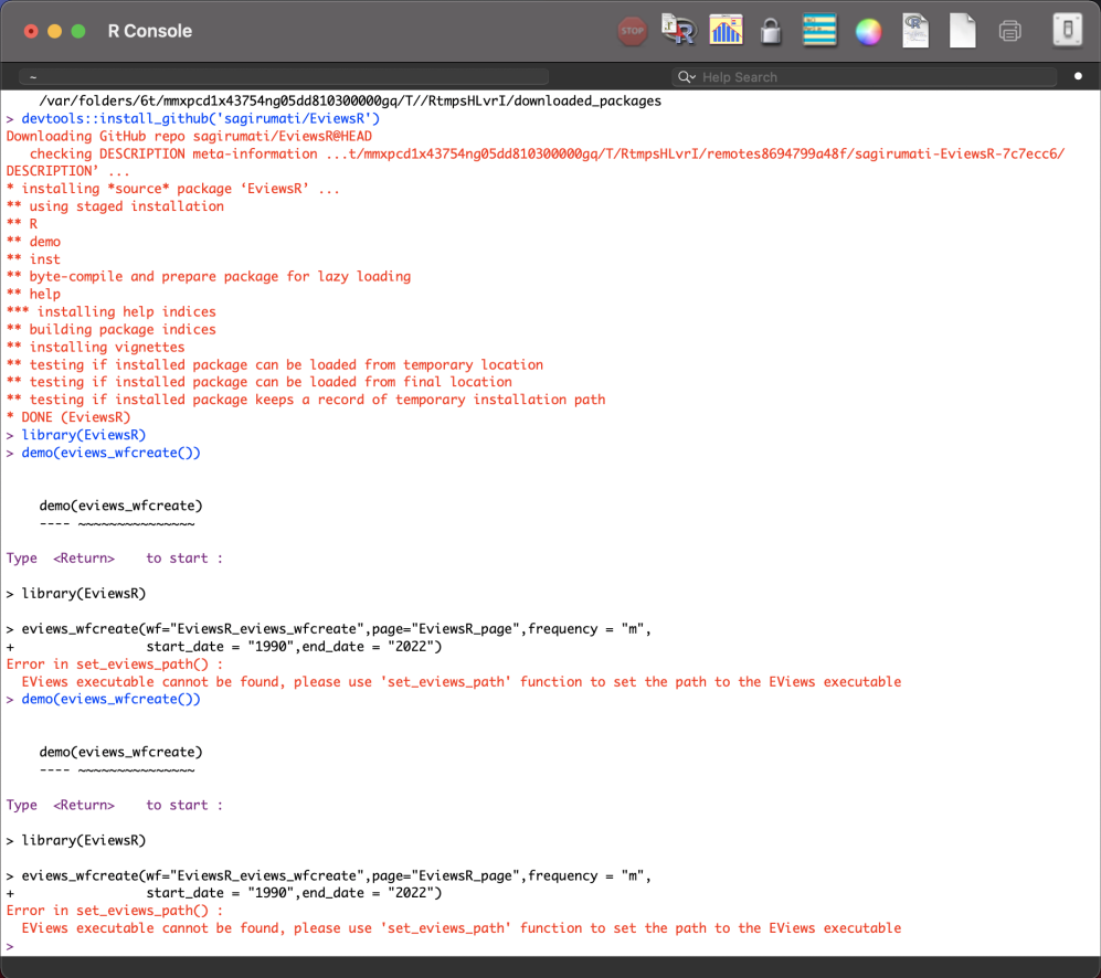

Postby EViews Steve » Fri May 20, 2022 10:58 am
Ok, got farther this time.
I have EViews 11 University & EViews 12 University installed on this mac. Since our student version can't save any output files, I'm assuming you wrote your library to use these university versions (we don't have a Mac version for our normal Standard & Enterprise version).
However, when I tried to run your demo, I got and error:
Let me know how I can change the path to the EViews executable.
Postby sagirumati » Fri May 20, 2022 1:46 pm
I am grateful for your time and effort.
Good news. We are almost there.
Now that you have the package installed, please run the following lines of codes:
library(EviewsR)
set_eviews_path("path/to/your/eviews/executable.exe")
demo(eviews_wfcreate())
If I know the default path to the EViews executable on macOS, I will make the package automatically detect the EViews executable.
Thank you once again

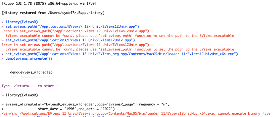

Postby EViews Steve » Fri May 20, 2022 4:37 pm
I tried to set the path to the EViews 12 application, but your set_eviews_path method didn't like that.
Then I tried to dig into our app contents and pinpoint the exact EViews exe file that is run by the app, but then your library didn't like that either.
By the way, our Mac app is done by using a Wine wrapper (EViews12Univ.app) around a special Windows version of our app (EViews12UnivMac_x64.exe). Even if you have the path to the actual Windows exe, you can't run it directly on the Mac (which is why we use a Wine wrapper).
I suggest you change your set_eviews_path to allow .app file extensions. And make sure it works with spaces in the pathname.
Here are the two attempts:
Postby sagirumati » Sat May 21, 2022 10:01 am
One more thing...
I just spoke with our Mac developer and he informed me that currently there's no way for the Wine app wrapper (EViews12Univ.app) to pass along a command line parameter to the Windows exe (EViews12Univ_x64.exe). So this means the Mac version can't currently run a program upon startup and then quit.
Because of this, I don't think your EviewsR library will be able to work with our Mac version.
Sorry.
Thank you for your feedback. Your effort is commendable.
You can set any character as the as path of EViews, the first error is because you used backlash (\) instead of a forward slash (/) in the path. Please try the following codes in R.
