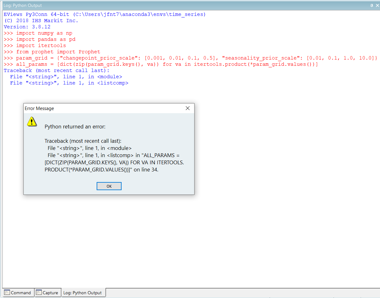

however, it sends me the following error
The same thing happens to me if I use Python 3.8 or 3.9.
Could you please help me identifying where the error is?

Did you try running the Python commands within Python directly without using EViews? If so, does it give you the same error?
When you do this, make sure you're using the same Python environment that EViews is talking to. EViews does a few things behind the scenes during a Python command, but this usually only done when going an XGET or XPUT call, not when simply running a Python command within XON.

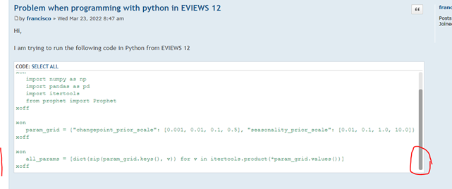

The reason I mention this is because your screenshot is strange in it is showing a Python command (last red line) that isn't in the original EViews program you showed at the top of your post (the line starting with 'all_params ='). Was this line actually in your program and you forgot to include it or did this line just appear out of nowhere?

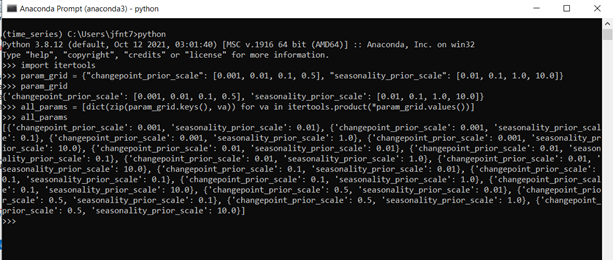

Thanks for your response Eviews Steve... I'm going to answer your questions.
YES and is OK
Here is the image with code posted…

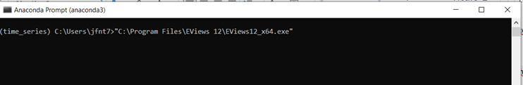

Finally, I noticed you're using a Python environment under Anaconda. To make sure you have access to all the same Anaconda managed Python libraries, update your EViews 12 to the latest version, then open an Anaconda command prompt, switch/activate to the proper 'time_series' environment, then launch EViews from that same command prompt so that EViews 12 is using the same environment variables that Anaconda sets up. Refer to this previous post that discusses using EViews with Anaconda.
Yes, that's how i'm doing it
As you can see, the code runs in Python environment time_series, but not when I want to run from EVIEWS 12.

After some extensive testing, I believe this error is being caused by our Python interface not supporting for loops, such as this:
xon letters = ['a','b','c'] for x in letters print(x) xoff
Even if you were to place all the lines of a for loop into a single line, like this:
xon letters = ['a','b','c'] for x in letters: print(x) xoff
You would still get an error when trying to run it thru our Python interface:
One possibility is to use an EXEC command for the single-line for loop, like this:
xon letters = ['a','b','c'] exec('for x in letters: print(x)') xoff
which results in this:
But using this method with your final command line didn't work, most likely due to the strange way the for loop is being used. Instead, I got the following to generate the same all_params value:
xon param_grid = {"changepoint_prior_scale": [0.001, 0.01, 0.1, 0.5], "seasonality_prior_scale": [0.01, 0.1, 1.0, 10.0]} all_params = [] exec('for v in itertools.product(*param_grid.values()): all_params.append(dict(zip(param_grid.keys(), v)))') xoff
