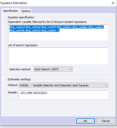

I have tried the new VARSEL function Auto-Search / Gets but always get an error message (see attachment).
I have also attached the way I specified the equations. It works with the stepwise method though.
Would you mind having a look, please?

Re: VARSEL Auto-Search / Gets
Is your copy of EViews up to date?
Yes it is. Eviews 12 latest update
- Posts: 13610
On the options tab of the estimation dialog, make sure you have the "bypass diagnostics failed by GUM" checkbox checked.
Great. That did the trick. Thanks a lot. Have a nice evening, Günter
