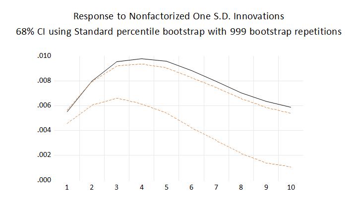

2. The "coefficient" of estimated IRFs sometimes is out of the computed bands when using bootstrap (please see the attached Photo). This is strange as estimated coefficients should always be within the estimated bands. The

1. In VAR01, you can find the first model identified NOT through a Cholesky factorization (indeed, there is a -8 in Matrix A and this is commonly used when employing SVAR modelling. Please open VAR01 and then click on proc and on estimate structural factorization to see that). When you compute IRFs with any bootstrap methods, you cannot compute IRFs and bands as an “internal Error 500” appears (for the estimation method, you have to choose in the ‘Impulse definition section’ the Structural Decomposition method as the identification is NOT a Cholesky). However, only when using a Cholesky factorisation and then a “Cholesky -dof adjested” method in the “Impulse definition section” (e.g., in VAR02 identification – see matrix A and B), bands can be computed with the bootstrap method.
2. If you estimate the VAR02 by imposing a Cholesky factorization (a “Cholesky -dof adjested” method in the Impulse definition), when you estimate IRFs’ bands with 68% confidence interval (for instance - by using the Bootstrap Standard Percentile, Hall’s percentile and also others), the ‘coefficients’ (Black line) are in some cases outside the computed bands (red bands). This should not occur.

I believe both of the issues you raised are now fixed. The Cholesky re-ordering issue has been fixed for a while now. The internal error 500 on custom impulse matrices fix should go out in the next patch.

EViews Mirza
- Posts: 95
- Joined: Sat Apr 22, 2017 8:23 pm
Re: SVAR bootstrap
We haven't pushed the fix out yet. I'll keep you posted when it goes out. However, it has been addressed.
