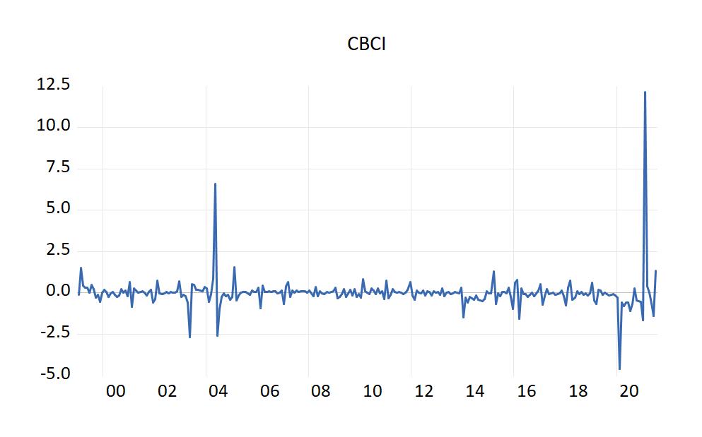

I constructed a state-space model to estimate the state variable. The model program works quite well at first. Picture 1 is the outcome I get from the estimation, the last observation of the model is June of this year. However, after I update the data to the July of this year, the outcome changed so dramatically, just as I showed in picture 2.
My model is a mix-frequency state-space model, which consists of four monthly variables and one quarterly variable. All of these variables are seasonal-adjusted then changed into their growth rates. I compare the seasonally adjusted data for every variable with and without the new observation. None of them show big differences. Therefore, it may not be the problem of the new observation or the seasonal adjustment.
So, I'd like to know why, and how to fix it. Thanks!
Picture 2, the outcome I think which is wrong.
Picture 1, the outcome I wanted.

It is impossible to answer this question with the information provided. A workfile with estimated objects would help.

The estimated sspace object is singular at the final values. I didn't delve too much into the specification, I don't think that your EMPG equation temporal disaggregation is working well.
