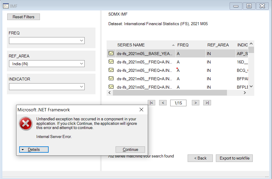

I am using the latest Eviews 12. When I browse the SDMX IMF, IFS 2021 M05 database, I am getting a Microsoft .net framework error.
"Unhandled exception has occurred in a component in your application..." see screen capture. Any ideas?

The latest patch of EViews (Aug 11 2021 build) has the fix on the issue.

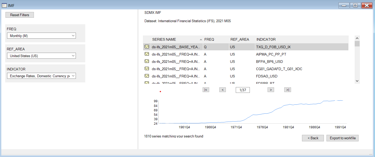

Thanks for your help. Now I am able to get it working but I am still encountering problems. The most significant is that the filters to narrow down on the series tend to get stuck on the second or third filter. This screen capture shows a session where you can see that not all of the filters are working.
Is it timing out?

Next, I noticed that a lot of the delays come from our controls attempt to display a list of series for the currently selected filter. If you see a "Please wait" popup saying it's retrieving series, you can safely cancel those and then immediately select the next filter criteria. That's why the cancel button is there.
