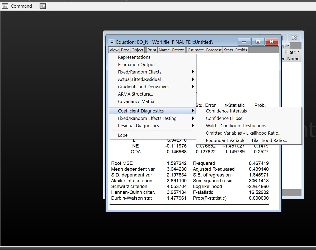

I am using Eviews 11 student version lite. I want to test multicollinearity through VIF but I am unable to find the option.Can anyone please help me how to do VIF test

Postby EViews Gareth » Mon Mar 15, 2021 9:06 am
What have you done so far?
shaliza
Posts: 14
Joined: Wed Mar 03, 2021 10:17 am
Re: Help!!How to check multicollinearity in these data?

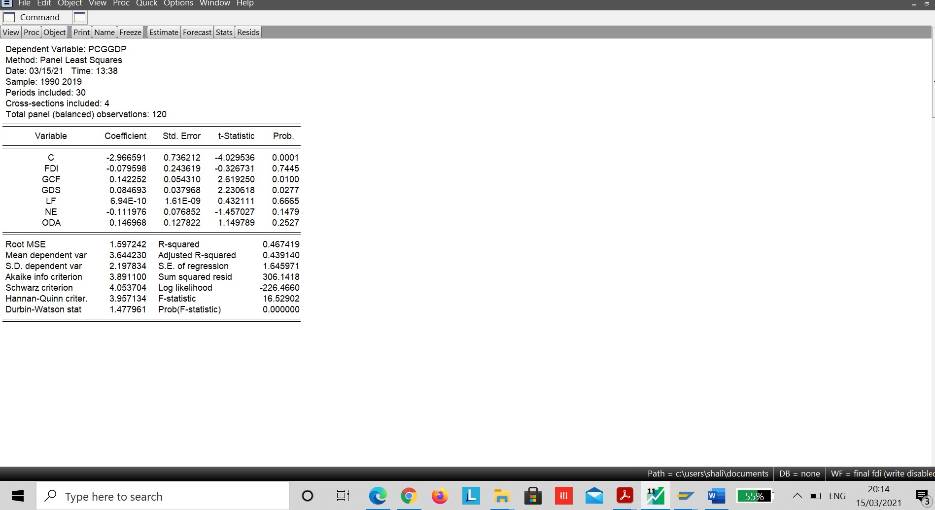

Postby shaliza » Mon Mar 15, 2021 12:17 pm
what I have done is attaching here
Posts: 13612
Postby EViews Gareth » Mon Mar 15, 2021 12:35 pm
VIFs are not available for panel data.

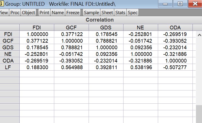

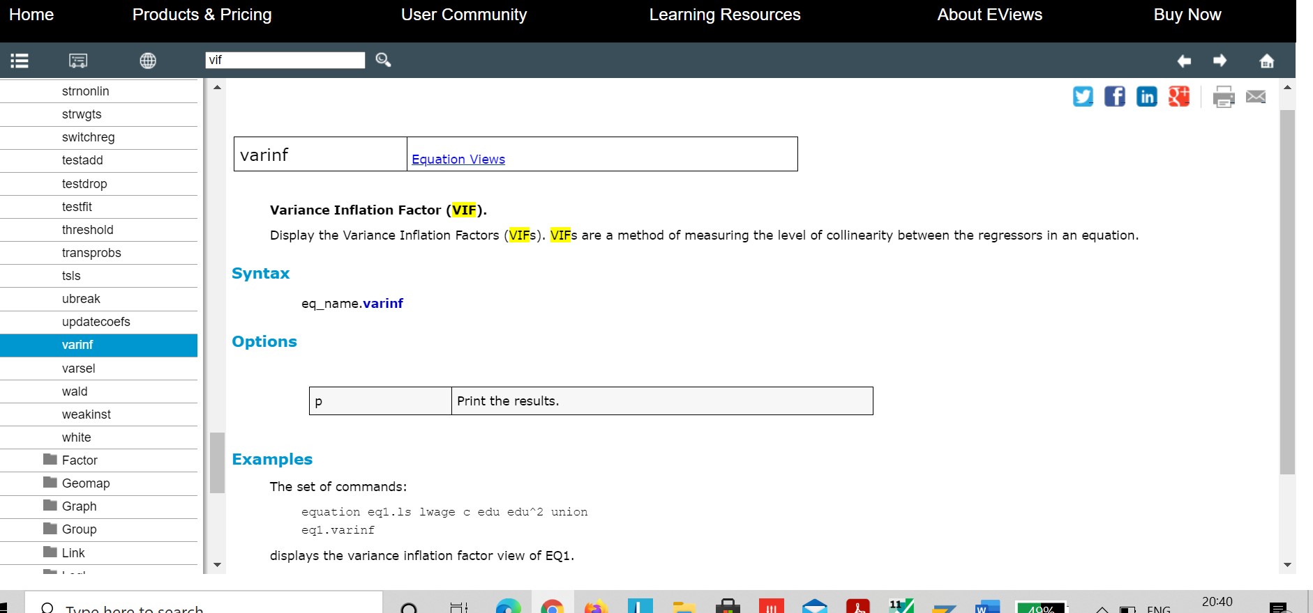

Then how can I check multicollinearity ,can you please help me. I have some paper where students did VIFs for panel data. here I am giving what I have got from Eviews help.and can you please tell me that I want to check multicollinearity for fixed effect model and is the follwiing correlation matrix is fine?
VIF command.jpg (156.55 KiB) Viewed 27408 times
Posts: 13612
Postby EViews Gareth » Mon Mar 15, 2021 1:27 pm
EViews has no multicolinearity measures built in for panel data
