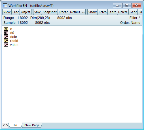

After the import wizard finished, here's what the detailed IMPORT command looked like for me:
If you run this last command directly within the EViews command window (or in an EViews program), you'll end up with a workfile that contains 3 columns from the source URL that you can refresh whenever you want.

The page you are referring to is showing exactly the same dataset as in my import example.
This data doesn't appear as a time series in the EViews workfile because it defaulted to being read in as an undated panel. And the reason for this is because the CSV data provided by SNB is in a "stacked" format. That means each row in their CSV file is keyed by both date and variable name. Hence there are multiple rows for the same date, but for different variables.
My initial example was only meant to show that it is possible for EViews to "link" to an external datasource via URL. And if SNB had provided the data in a normal "unstacked" format (e.g. date, var1, var2, var3, etc. on each row), then EViews would've recognized the pattern and then imported them where each variable column was its own separate series object.
But because of the "stacked" format, you'll have to do an additional step to get it into the unstacked format you're looking for. Here are my suggestions:
First, import the same CSV file into a dated panel workfile (this import command is slightly different than before):
Once imported, do a page unstack to a new page:
Now you should see your data elements as you expect on the new workfile page.
Because the unstacked page is not "linked" to the first page, you'll have to recreate/re-run the pageunstack command every time you refresh the first linked page so that you can get all the new data.
