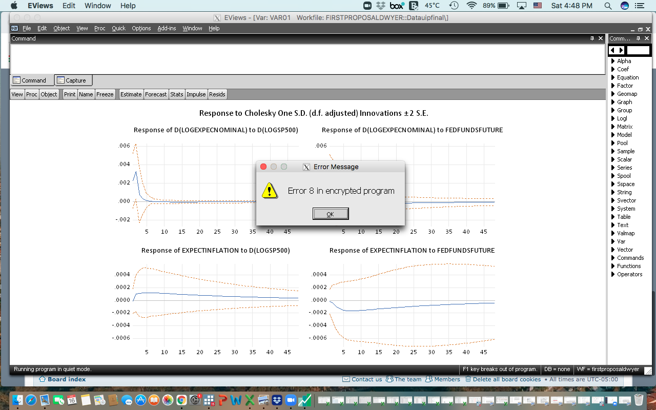

I am sort of new to Eviews but have some time series background. For now, I am doing a standard VAR. Nevertheless, given that I have a relatively small sample for a VAR(2), the non-normality assumption is not satisfied. Given that, I am trying to use the "Killian-Bias Adjusted Bootstrap Add-in" to adjust my standard errors. Nevertheless, when I press "Proc" on my VAR estimation to use the mentioned add-in, I am getting the following error:
"Error 8 in encrypted program"
I would highly appreciate if anybody could tell what error I am having and, if possible, how to fix it so I can bootstrap my standard errors.

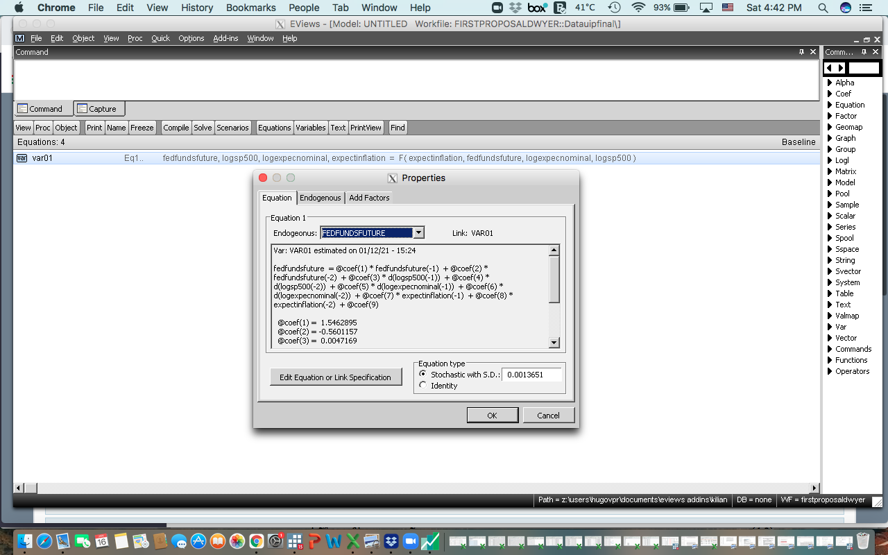

Please describe the specification of VAR model.

Postby hugovpr » Sat Jan 16, 2021 2:43 pm
Please find attached
Screen Shot 2021-01-16 at 4.42.50 PM.png (173.6 KiB) Viewed 31321 times
Screen Shot 2021-01-16 at 4.48.11 PM.png (213.66 KiB) Viewed 31320 times

You should create variables before the estimation. For example:
series dlogexpec= dlog(expecnominal) or series dlogexpec=d(logexpecnominal)
Do not use expression such as log and difference.

Postby hugovpr » Tue Jan 19, 2021 7:29 am
Is there any manual or something related? I just want to know exactly what the error means so I can fix the issue
