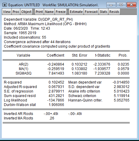

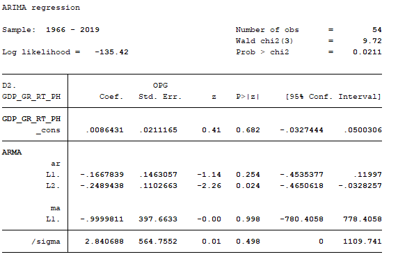

i am new user of EVIEWS and i am currently running an ARIMA (2,1,1) model however as I compared it to STATA, EVIEWS results only displayed one coefficient for AR while STATA displayed 2 coefficients for AR. your feedback is highly appreciated

In EViews, AR(2) means the second AR coefficient rather than two AR coefficients. You probably want AR(1 to 2)
