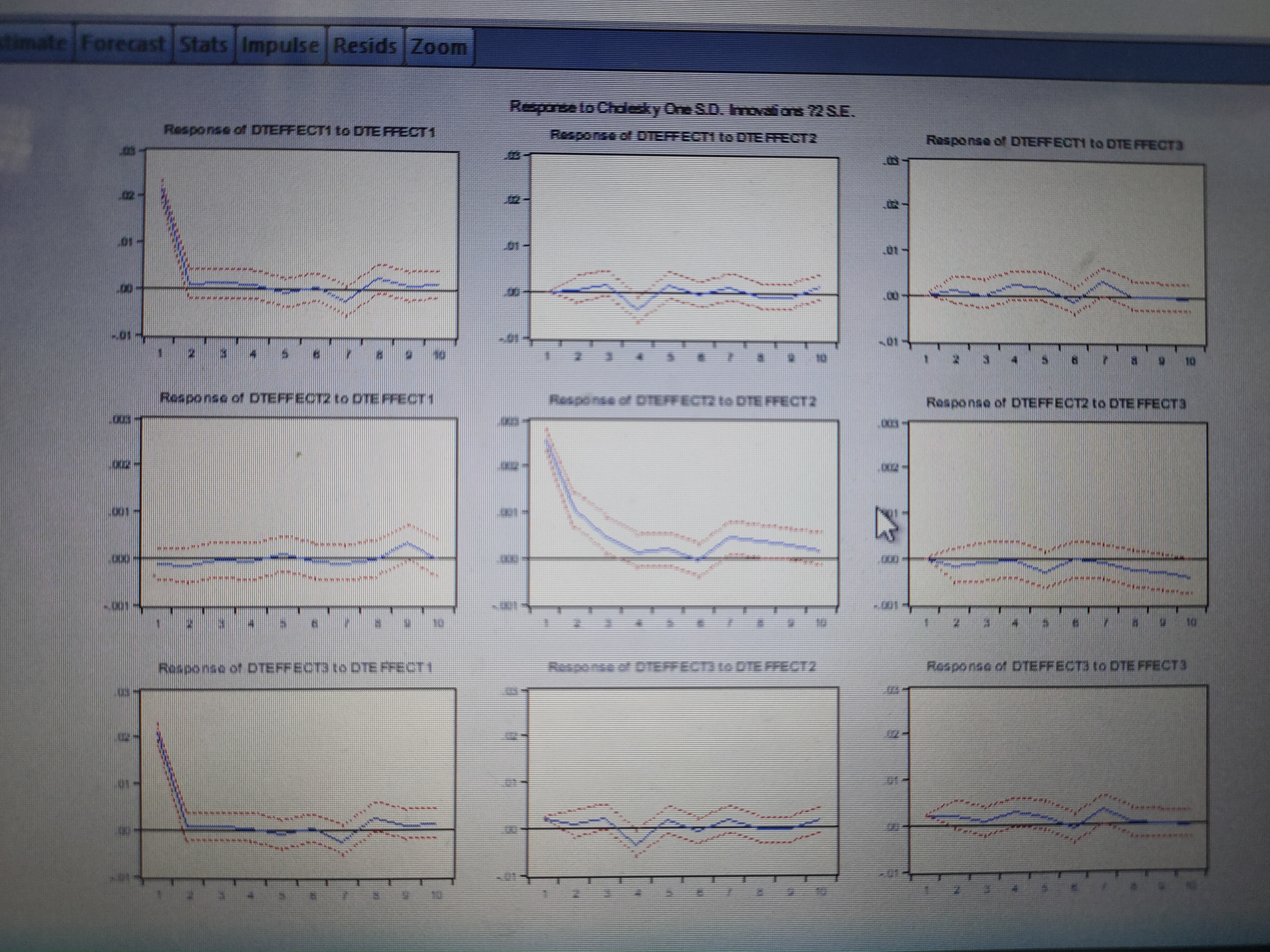

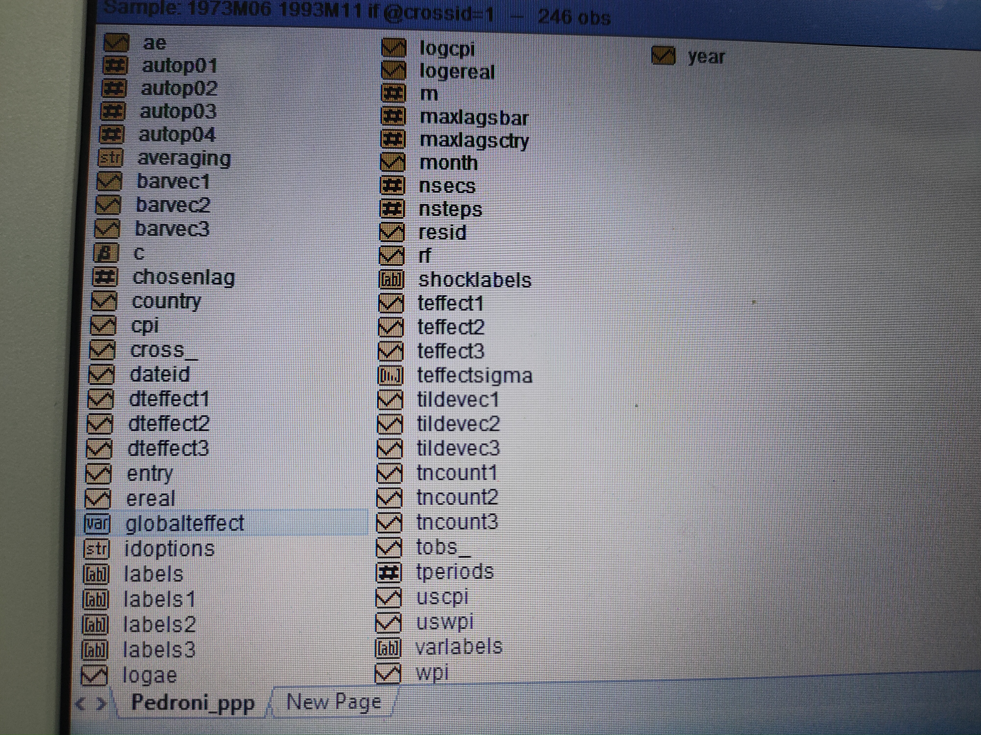

when use i your example data to try the add-in, I meet error message " syntax error" .
and the result show in the picture
you say"The resulting output will be three graph objects that contains 3x3 charts similar to those produced by EViews’ VAR object", so are the resulting output is in "globalteffect"? but it does not draw like what you show in your blog:Panel Structural VARs and the PSVAR add-in
and I can't get “composite” “common” “Idiosyncratic” respectively.
