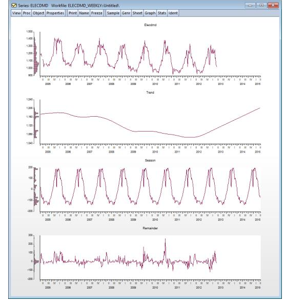

I am using STL function to seasonally adjust weekly data.
According to the help page, STL assumes an additive relationship between the seasonal, trend and remainder components.
help page.PNG (226.85 KiB) Viewed 24240 times

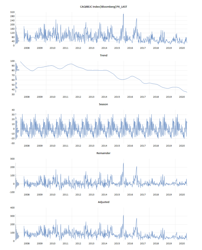

However, when I run the function I got trend, season, remainder and adjusted.
what I got.PNG (162.44 KiB) Viewed 24240 times
What is the adjusted here?

Adjusted = Actual - Seasonal
Thanks a lot. Make sense
