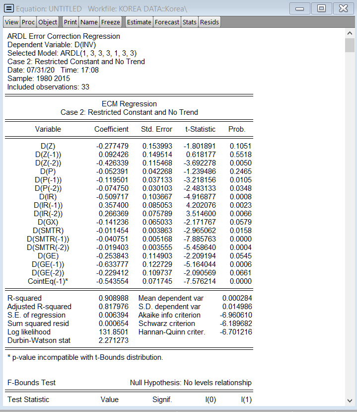

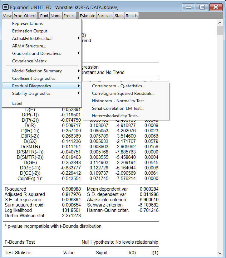

Hello. When I run the Error Correction Form in Eviews, it produces the ECM/ARDL parsimonious model.
When I then run the residual diagnostic tests (as pictured) for Normality, Serial Correlation and Heteroskedasticity, and CUSUM, are the results from the ECM/ARDL Model or the original ARDL model given when first running the ARDL Model? Can I use these results for my ECM/ARDL Model?
Collecting Residual results are obviously very important. Thank you.

Postby EViews Gareth » Fri Jul 31, 2020 7:42 am
Original ARDL

So how do I find the residual results for the ECM/ARDL?
Bth the original ARDL and the parsimonious ECM/ARDL use the same seated mod, so I'm guessing they have the same residual result???
The residuals from the contemporaneous and the ECM model are identical. All inferences on the residuals generated internally hold true regardless of the model transformation. Remember, the ECM is just a re-expression of the contemporaneous ARDL form. You can also verify this with a simple program I've attached below.

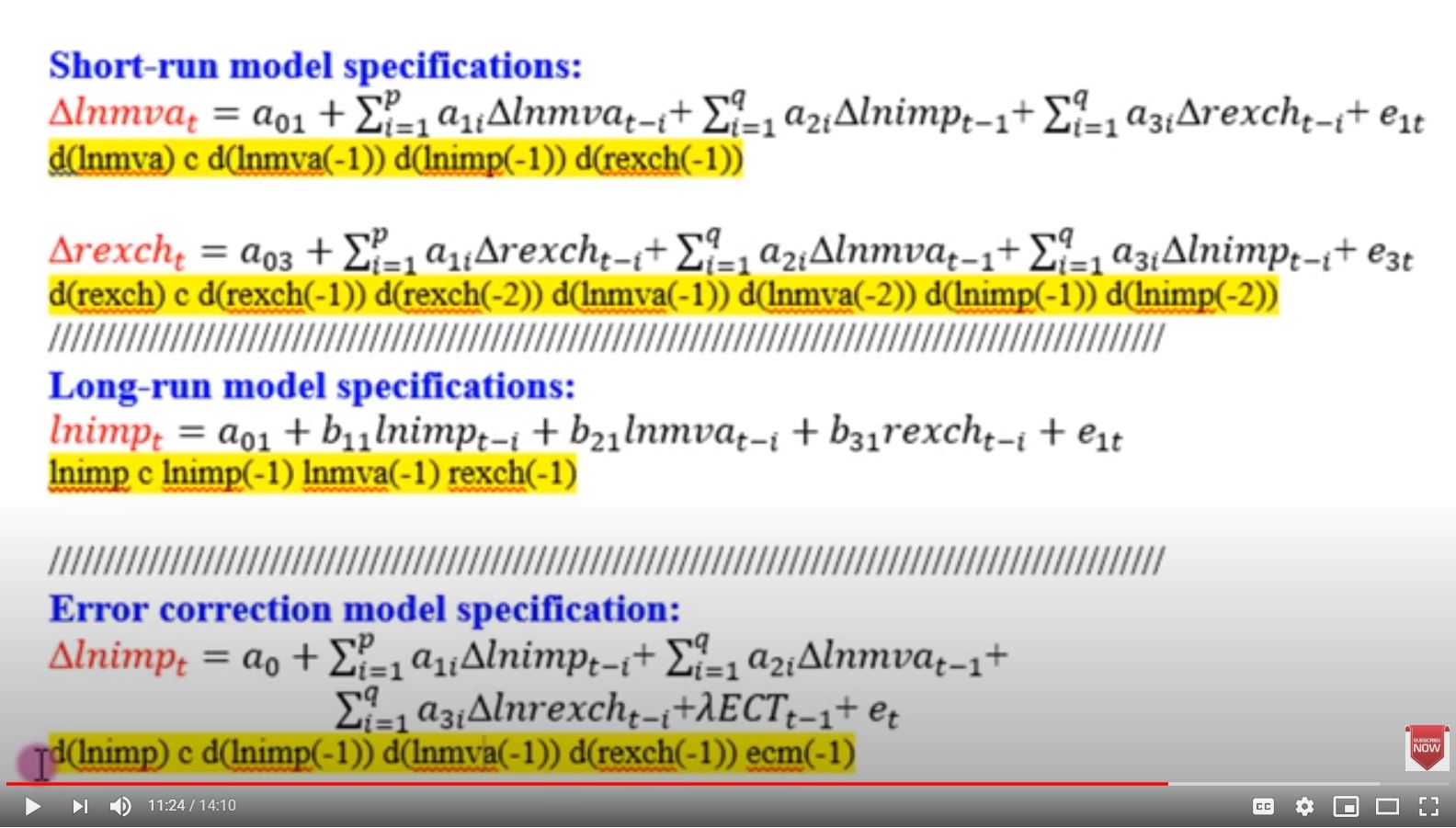

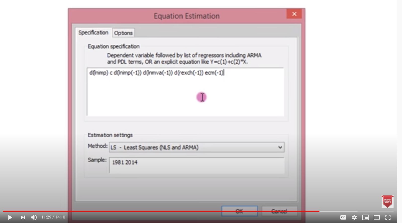

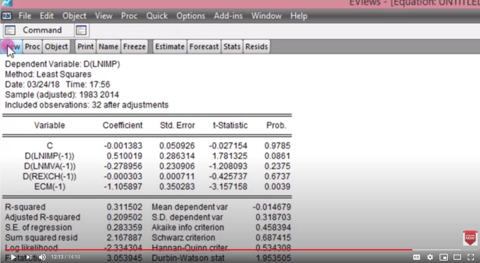

In explaining it simply, I have added photors:
Photo 1: Shows the short-run and long-run model specifications used in the LS - Least Squares method.
Photo 2: Using the long-run specification, you create the ECM series. Then you place in the LS equations (short run and long run) and run the model
Photo 3: You run the short run and long run (EMC model) with the LS method. The ARDL-ECM model is then displayed
As you can see, this is a different method used.
Are you able to tell me why authors use this method?
My supervisor seems to think that the long-run model is not specified properly here.
If you did this method and compared it to the Eviews method (that we have spoken about), the long run model and ARDL contain different coefficients completely.
What are you thoughts?

What is presented on the slide (last two lines) is nothing more than Engle-Granger procedure without testing for cointegration at the first stage (static long-run equation). I highly recommend not only watching videos on the Internet, but also reading original papers on the subject, as well as an exhaustive Eviews blog on the ARDL modeling.

Once again: Long-run model specification and error correction model specification on the slide are not directly related to ARDL Bounds test. Long-run model specification is like the static level equation in Engle-Granger method. The error correction model specification is like second stage dynamic equation in Engle-Grander method. Definitely, OLS is correct here, see Nobel-price paper in Econometrica. Generally, the results will not coincide with ARDL model since it takes into account dynamics while estimating the long-run. So what is your question about? Eviews ARDL Bounds test is implementation of Pesaran et al procedure and nothing more (Eviews makes this even better than original paper and Microfit). All deterministic terms specifications in Eviews are strictly the same as in Pesaran et al (2001). What Narayan (2005) had added to this?
